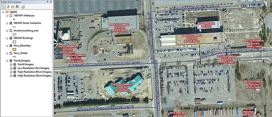

The addressing process is done in ArcGIS for Desktop. Users can see address labels, centerlines, street names, and the street ranges.
