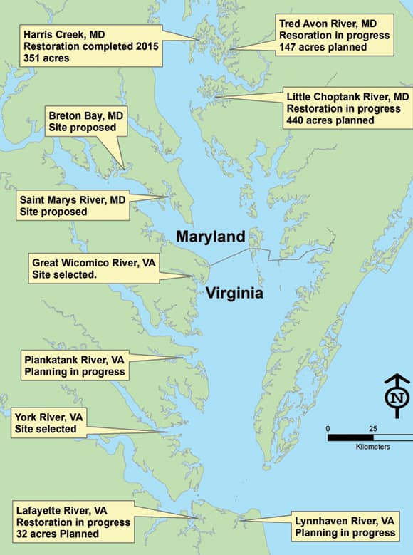

To remedy these losses, the Chesapeake Bay Program is leading the effort to do large-scale oyster habitat restoration and revitalize native oyster populations in 10 bay tributaries by 2025. Centered on sanctuary (i.e., nonharvest) areas, this requires augmenting reef ecosystem habitats, promoting oysters’ water filtration services, and conserving mature oyster brood stocks to ensure that a steady source of wild larval oysters can colonize surrounding areas that are open to commercial harvest.
Chesapeake Bay oyster rehabilitation projects
The Chesapeake Bay Program is leading the effort to revitalize native oyster populations in 10 Chesapeake Bay tributaries by 2025. (Map courtesy of the NOAA Chesapeake Bay Office.)

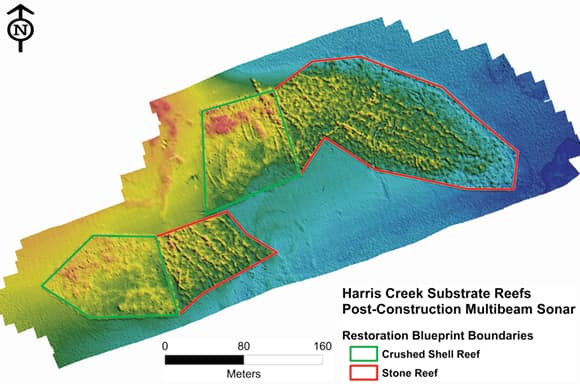

A digital surface model shows new reefs
A digital surface model shows the new reefs in Harris Creek. Warm colors indicate higher-elevation reefs and, thus, shallow water, while cool colors show lower-elevation reefs and deeper water. NOAA will use digital surface models like this to update its nautical charts. (Image courtesy of the NOAA Chesapeake Bay Office.)

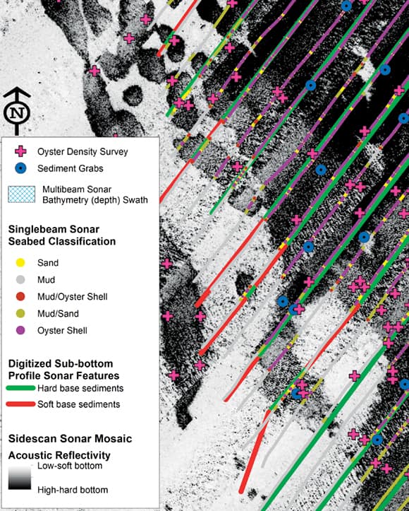

For the Harris Creek project, the Maryland Oyster Restoration workgroup began by creating a feature class in ArcGIS Desktop that identified the distribution of natural oyster shells, as well as hard and soft nonshell bottoms. To do this, the workgroup used side-scan sonar mosaic imagery, which identifies the distribution of hard and soft seabed; single-beam sonar seabed classification points, which distinguish seabed bottom types; and sediment grab point data, which is derived from sediment samples. The resultant habitat polygons were then used to draw up an oyster population survey in ArcGIS Desktop.
With this survey data, the workgroup then employed geoprocessing tools in ArcGIS Spatial Analyst to interpolate the density of live oysters in certain areas. The output grids were reclassed into two bins that identified areas that do not meet the density target (50 or more live oysters per square meter) and areas that do.

To finalize the boundary geometry for the new reefs, restoration partners conducted subsequent acoustic and ground truthing surveys on the blueprint sites. They did additional depth surveys using sonar to ensure that the reefs were built in areas that were deep enough so they didn’t cause new navigational hazards. They used digitized features from sonar-based sub-bottom profiling surveys to verify that subsurface sediments could support the weight of the new reefs. And they employed new sediment grab points to verify the presence or absence of oyster shells to avoid constructing new reefs on top of existing natural habitats.
Sonar surveys characterize seabed habitat
Sonar surveys characterize seabed habitat and locate areas where there are fewer than 50 oysters per square meter. This helps the team pinpoint where oyster restoration sites should go. (Map courtesy of the NOAA Chesapeake Bay Office.)

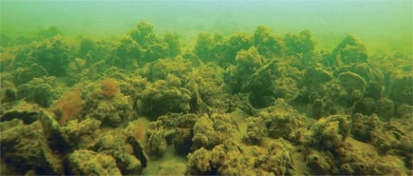

A revitalized crushed shell reef
A three-year-old crushed shell reef in Harris Creek contains an abundance of live oysters and associated organisms. The vertical orientation and density of oysters indicates that this site has not been disturbed by commercial fishing activity. (Photo courtesy of the NOAA Chesapeake Bay Office.)
