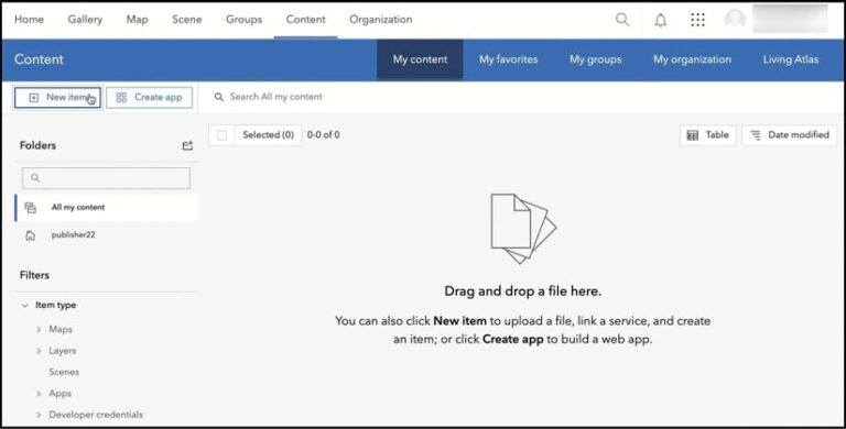

For data that doesn’t get updated very frequently and is in a ready-to-use state for mapping, analysis, or reporting, it is easy to add this data to ArcGIS Online directly from its source. Users can add data from a local drive or network or by uploading the data from various cloud storage solutions such as Microsoft OneDrive, Google Drive, and Dropbox.
The ArcGIS Online interface, with the My content tab All my content option selected and a big window in the center of the page that says, “Drag and drop a file here”
For ready-to-use data, users can add it to ArcGIS Online directly.
ArcGIS Online supports a long list of file and data formats. Users can add zipped shapefiles, zipped file geodatabases, and CSV files containing location information directly to ArcGIS Online by going to the My content tab and either selecting New item or dragging the files into the window. From there, users can create web layers out of their files, transforming the data into a format that is ready to use in web maps, web apps, and analysis tools.
Adding data directly to ArcGIS Online is a great option for when a user’s goal is to ingest a static, one-time copy of the data. If the source data changes regularly, is frequently edited, or is growing, then it might be challenging to keep the data current. Users would need to either overwrite relevant items with the latest copy of the data or write a Python script in a notebook to automate the task.

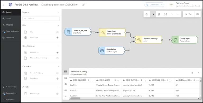

If the source data is edited outside ArcGIS Online or needs to be cleaned, formatted, and transformed prior to using it in a web map or analysis workflow, it’s best to use ArcGIS Data Pipelines. This is a native data integration capability in ArcGIS Online that’s available out of the box to all ArcGIS Online organizations.
The ArcGIS Data Pipelines interface showing a flowchart of how data gets integrated into ArcGIS Online
ArcGIS Data Pipelines connect to cloud-based data stores.
Data Pipelines offers a low-code, drag-and-drop visual authoring experience that allows users to design data pipelines that ingest, prepare, and engineer data so it is ready to use for mapping, analysis, and reporting. Data Pipelines can establish secure connections to a variety of cloud-based data stores, including Snowflake, Google BigQuery, Amazon S3, and Microsoft Azure Blob Storage. It also supports other data sources such as public URLs and existing feature layers.
Data Pipelines goes beyond merely ingesting data; it can be used to clean, combine, and format datasets. The transformed data is then written out to a feature layer, making it ready to use across ArcGIS. Data Pipelines also includes built-in scheduling functionality that enables users to run their data pipelines on a recurring basis. Thus, as the source datasets change and evolve, Data Pipelines can be used to keep the related layers in ArcGIS Online up-to-date.

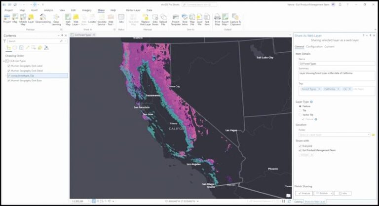

Many users start their workflows in ArcGIS Pro, where data creation, editing, and analysis take center stage. ArcGIS Pro offers the flexibility to connect to many different types of data, including files stored on a computer or network drive and data that resides in enterprise geodatabases, cloud data warehouses, and other locations. Users can connect to various data sources, leverage their data in maps and scenes, and perform advanced analytics and visualizations in 2D and 3D.
Once the data is curated, it can be shared to ArcGIS Online as web layers, web maps, web scenes, and more, depending on the use case. This fosters collaboration both internally and externally, whether in the office or around the world. Once the data is published to an ArcGIS Online organization, it becomes available to edit, query, visualize, analyze, and collaborate with.
If the source data changes and updates need to be made to the data in ArcGIS Online, users can either manually overwrite the web layers or automate the process using ArcGIS Python libraries in a notebook or script.

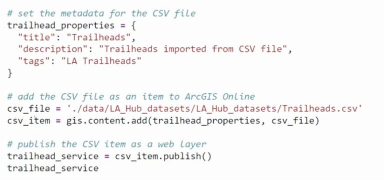

When data integration needs are complex or must be automated and no out-of-the-box or commercial off-the-shelf solutions fit the bill, developers and GIS practitioners can use the ArcGIS Python libraries—Python packages that include ArcGIS API for Python and ArcPy.
A Python script that shows how trailhead names can be imported as an item from a CSV file into ArcGIS Online
With ArcGIS Python libraries, users can author powerful Python scripts.
These are powerful, modern Pythonic libraries that provide a consistent experience across ArcGIS for scripting and automating, and they can be used to integrate data.
With ArcGIS Python libraries, users can author Python scripts to connect to an extensive array of data sources and file formats, perform advanced data manipulation and analysis, and write the results to web layers in ArcGIS Online. The Python API has functions and methods for adding and publishing files, packages, and Spatially Enabled DataFrames as web layers in ArcGIS Online. ArcPy can share, overwrite, and replace web layers using a combination of functions and geoprocessing tools.
ArcGIS Online includes ArcGIS Notebooks, providing an integrated platform for writing, running, and scheduling automation scripts using the Python API and ArcPy. Python scripts that leverage these libraries can also be written and run externally to ArcGIS Online.
