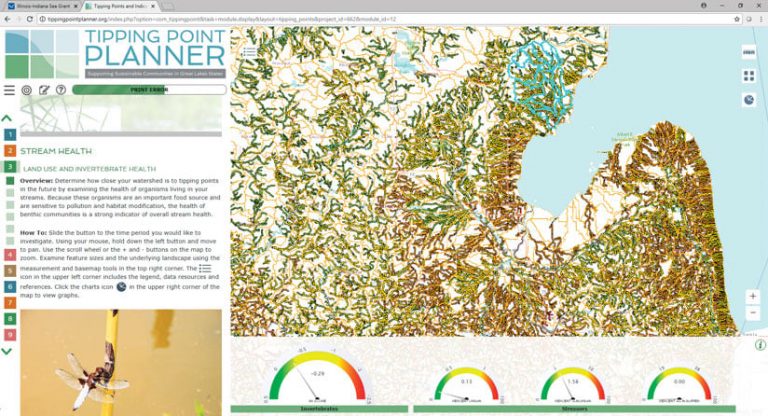

A screenshot of the Tipping Point Planner showing a map, a photo of a stream, and a video
The decision support tool helps program participants evaluate natural resources, prioritize community goals, assess changes, and explore what-if scenarios to come up with action plans.

The result of this partnership is the Tipping Point Planner Program, a facilitated workshop designed around a collaborative, web-based decision support tool that provides communities with information about local land use and watersheds in various multimedia formats. The interactive modules help participants do four things:
  • Evaluate natural resource assets.
  • Prioritize community goals.
  • Assess past and potential future changes by displaying maps and gauges that indicate tipping point status.

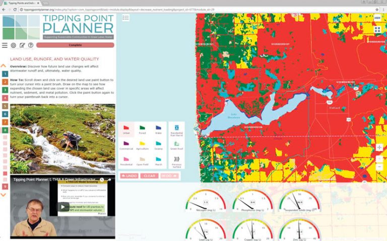

  • Explore what-if scenarios with real-time models.
At the end, the Tipping Point Planner generates an action plan that brings together these four items in a PDF, which contains maps, charts, and planning priorities.

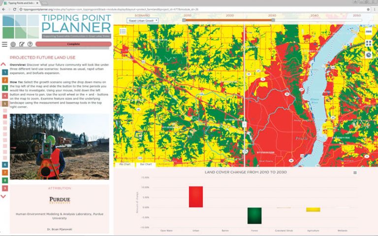

In Tipping Point Planner workshops, participants get to evaluate how proposed land-use changes may affect water quality in their communities. The online decision support tool integrates a variety of spatial models. These include Purdue University’s land-use forecast tool, called Land Transformation Model (LTM); water quality tools such as Purdue’s Long-Term Hydrologic Impact Analysis (L-THIA) model and the US Geological Survey’s (USGS) SPARROW (Spatially Referenced Regression on Watershed) model; and the University of Michigan’s land-use biotic tipping point model, which provides users with the status of nutrients, sediments, fish, and aquatic insects in streams. Incorporating separate models like this enables planners to analyze a range of plans over a period of two to five decades.
Additionally, the Tipping Point Planner’s GIS-based tools enable users to visualize the results of the models on a map. Users can zoom in and out and pan across the map to see stream quality ratings at different spatial scales (e.g., local versus regional). The team also employed the National Hydrography Dataset alongside land-use classification to generate a seamless network of stream reaches and elevation-based catchments, which allows users to see how land drains into specific rivers or streams. And topical pages, which show things like how to decrease nutrients or protect farmland, are modeled after ArcGIS StoryMaps, with a narrative pane on the left that guides users through the decision support tool and a main stage on the right where users interact with the map, data, and graphs.

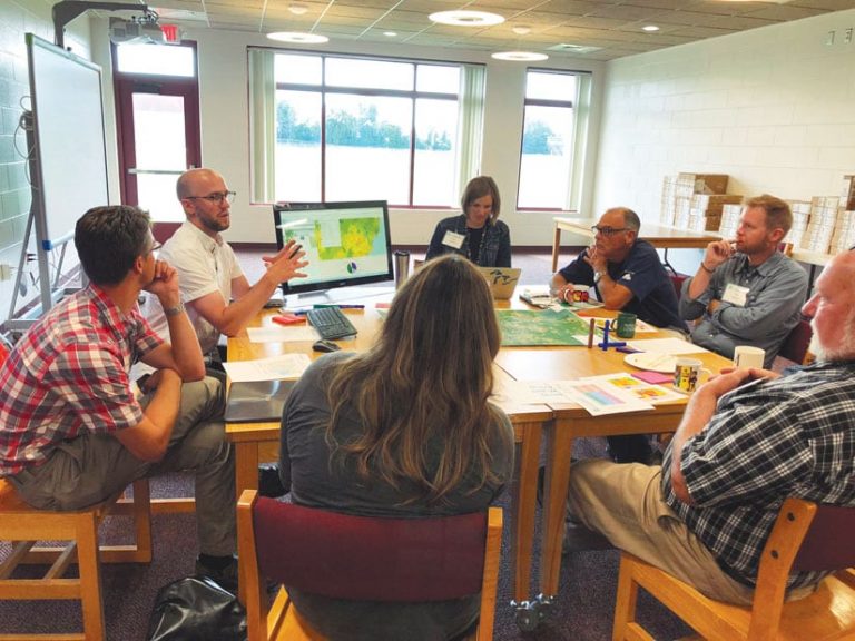

A photo of seven people sitting around a table talking
In Au Gres, Michigan, community leaders participated in a two-day facilitated workshop put on by the Tipping Point Planner Program to examine opportunities to protect nearby watersheds.

To address the future of two watersheds near Saginaw Bay in Lake Huron—the Au Gres River watershed and the East Branch Au Gres watershed—two Tipping Point Planning team partner organizations, Michigan Sea Grant and Huron Pines, hosted a Tipping Point Planner workshop at Au Gres High School in July 2018. Over two days, community leaders, citizens, city planners, and natural resource professionals from the Saginaw Bay area took part in scientist-led group sessions and used interactive tools to explore three topics: green infrastructure, open space modeling, and nutrient modeling.
Workshop participants ended up finding out that their watersheds are in great condition but that they lack a plan to protect these largely unadulterated landscapes. Using the Tipping Point Planner modules, attendees identified priority areas for conservation.
Following the workshop, participants had access to the decision support tool and worked on generating a finalized action plan. A month later, the Tipping Point Planning team hosted a follow-up workshop with the partner organizations to support their action planning efforts.
