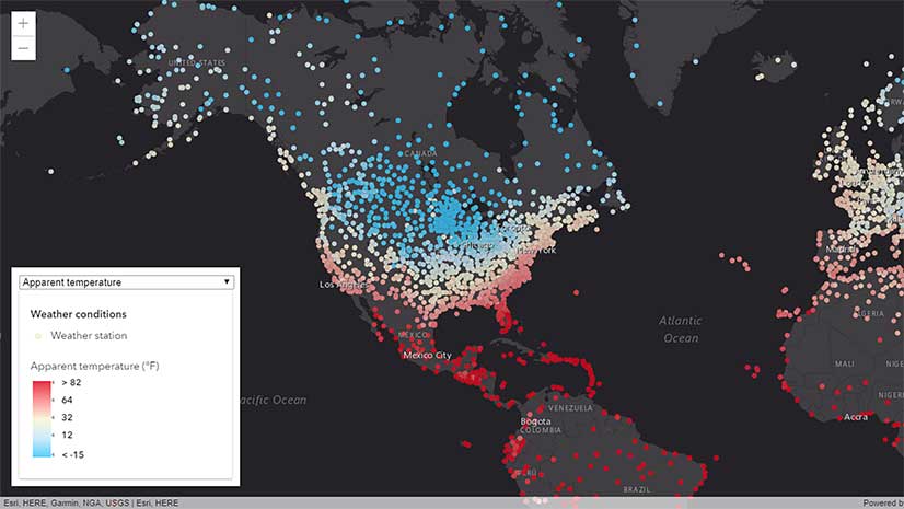

The ArcGIS API for JavaScript has evolved. It now provides a GeoJSON layer to fully support GeoJSON data sources. The GeoJSON layer allows you to easily pull in GeoJSON data by referencing the URL and adding the layer to the map (Fig. 1).
Attributes data can drive the size and color of map symbols.

The fun doesn’t end there. You can add pop-ups and labels and style features using the same techniques you use to visualize data in other layer types. You control how each attribute in GeoJSON data drives the color, size, opacity, and rotation of features. All smart mapping capabilities are available with GeoJSON layers.
