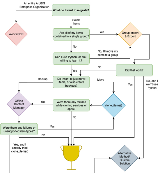

Flowchart illustrating the options outlined in the article.
Migration Options at a Glance
To help illustrate these options, the flowchart above covers different scenarios and recommendations to migrate your content across ArcGIS Enterprise organizations. For migrations involving an ArcGIS Online organization, ArcGIS API for Python must be used. To follow the options available for ArcGIS Online, start near the center of the flowchart, in the box that says, “Do I want to just move items, or also create backups?” Note that collaborations aren’t included as a workflow in the flowchart, as it is intended to highlight migration options (re-creating content) as opposed to sharing content.
