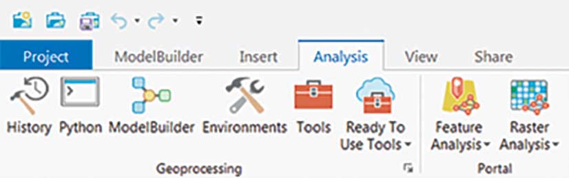

Click ModelBuilder on the Analysis tab.

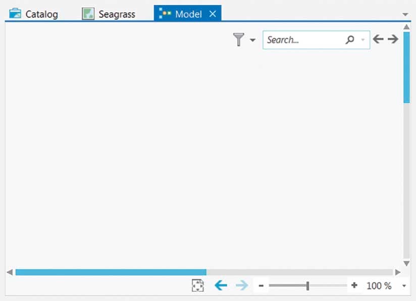

On the Analysis tab, click ModelBuilder. An empty model window opens.
Tip:You can also open a new model by right-clicking the toolbox folder in the Catalog pane and choosing New > Model.
Now set the model properties by clicking Properties on the ModelBuilder tab.
In the General tab, the option to Store tool with relative path should be selected, because using relative paths prevents headaches down the road if your data is moved.
Set these properties:
Click OK.
A blank canvas for building your model opens.

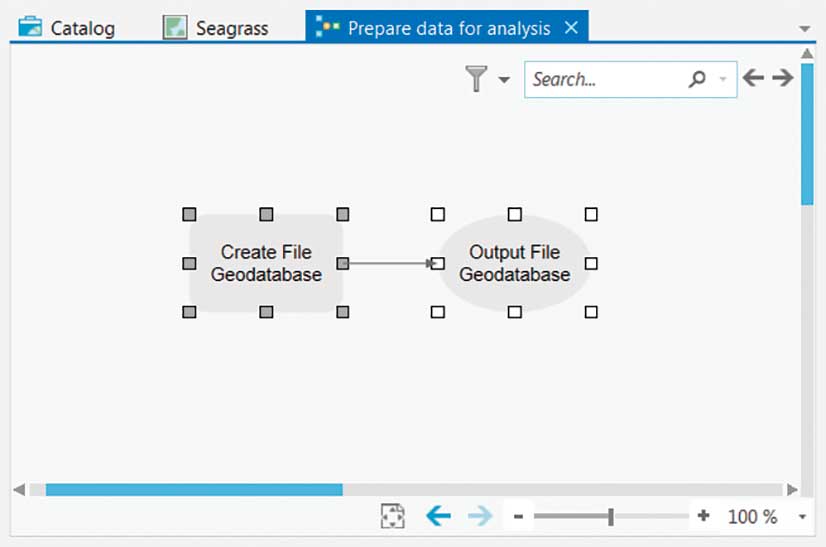

With the basic setup done, now comes the fun part. You can’t beat ModelBuilder for easy drag-and-drop building and tinkering. But first, you will need to understand some ModelBuilder vocabulary. A model consists of one or more processes. A process consists of three elements: input data, a tool, and the tool’s output. Each output can become input for the next process.
When you add a tool to a model by dragging it from the Catalog or Geoprocessing pane, its output element is also added, and both elements are light gray. In model parlance, gray means not ready to run.
Double-click each tool and set its parameters. A red asterisk next to an item in a tool dialog box means the parameter is required. Set tool parameters and pay attention to red asterisks.

When you add a tool to a model by dragging it from the Catalog or Geoprocessing pane, its output element is also added and both elements are displayed in light gray.

When all the required parameters for a tool are set, it colorizes and is ready to be run.
