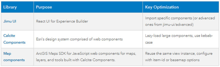

Each library plays a unique role in Experience Builder development. Knowing when and how to use each one helps you avoid unnecessary overhead.
Table with each of the three component libraries discussed in the article, outlining each library’s purpose and key optimization.

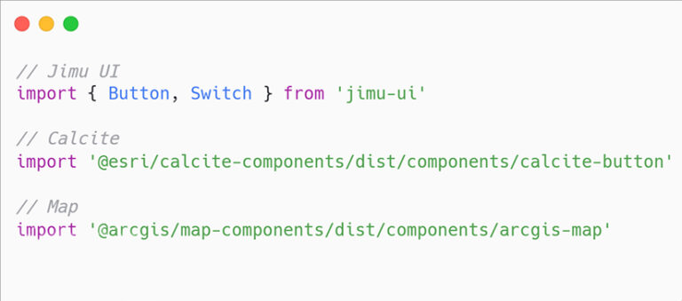

Code snippet 1 shows the imports statements for each library.

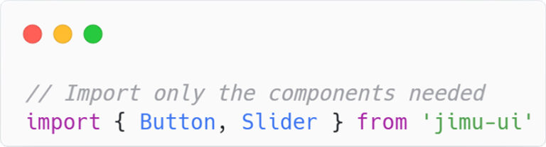

Large imports are among the most common causes of slow widget load times. If you import entire libraries, your production bundle grows unnecessarily. Import only the components needed to improve performance and your bundle, as in snippet 2.
Screenshot of a snippet of JavaScript code to be used within ArcGIS Experience Builder.
Snippet 2

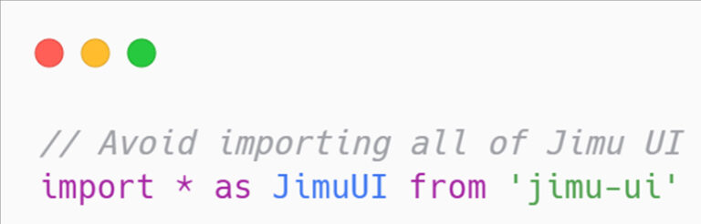

You can also avoid importing everything from libraries, as in snippet 3.
Snippet 3

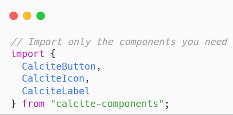

For Calcite Components, ArcGIS Experience Builder includes those components as part of its architecture. Starting with version 1.8, you can import Calcite Components directly from the calcite-components entry bundled with Experience Builder. You should avoid wildcard imports, and import only the components you need, as in snippet 4.

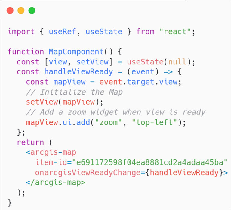

Next, as in snippet 8, reference the MapView for reusability.
Snippet 8
Reusing a single map instance is important for building efficient web apps. Multiple initializations can slow down performance and increase unnecessary API calls, while a single map ensures that layers, widgets, and state remain consistent across your app.

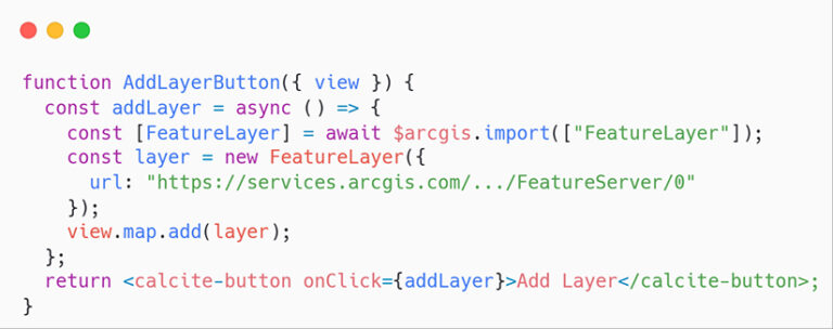

You can configure <arcgis-map> using an item-id (for a web map or web scene) or define properties directly, such as basemap, center, and zoom, depending on your workflow. Avoid re-creating the map unnecessarily, and load tools like an <arcgis-legend> or <arcgis-layer-list> only when needed. These strategies can dramatically reduce your widget’s initialization time.

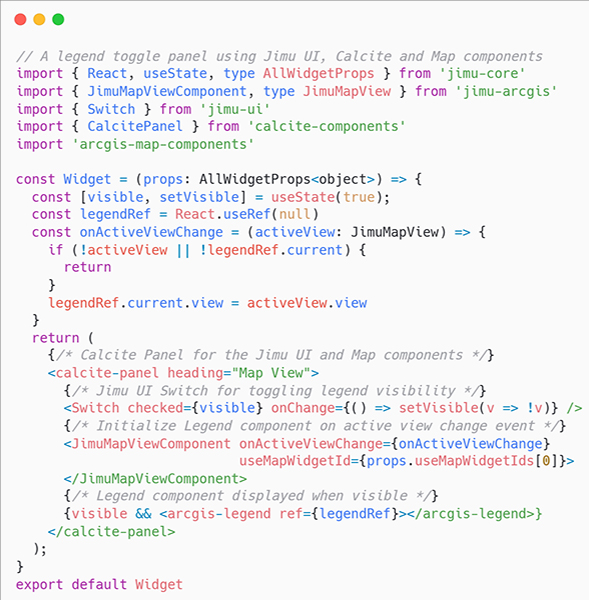

To show how these component systems can work together, snippet 9 contains an example using Jimu UI, Calcite, and Map components in one widget.
Snippet 9
This custom widget demonstrates how you can use Jimu UI for interaction, Calcite for layout, and the Map component APIs for display—all with minimal overhead.

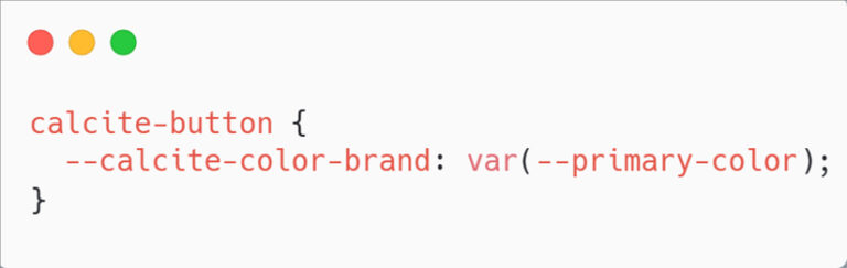

When using Calcite Components, rely on CSS custom properties rather than global overrides, as in snippet 11.
Snippet 11
