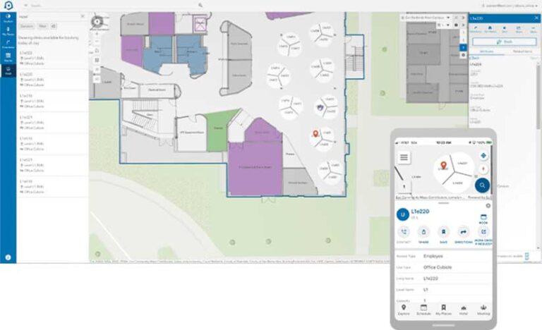

ArcGIS Indoors makes data easily accessible to decision-makers through dashboards.

ArcGIS Indoors, combined with existing products already licensed through our Esri educational agreement, gives URI these capabilities and more. In addition, the campus community will be able to access ArcGIS Indoors using a sleek graphic interface that is available on the desktop, the web, and mobile devices and through kiosk applications that are included with the license.

The campus community will be able to access ArcGIS Indoors via graphic interface available on the desktop, the web, mobile devices, and kiosk applications that are included with the license.
