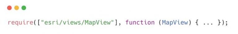

With both AMD and ES modules, API functionality is divided into logical subsets and packaged as modules. AMD modules use a require() method and a third-party script loader to load modules and their dependencies.
ES modules are an official, standardized module system that works natively with all modern browsers through import statements. ES modules do not require a separate script loader. An example showing the differences between the two coding patterns is shown in Listing 1.

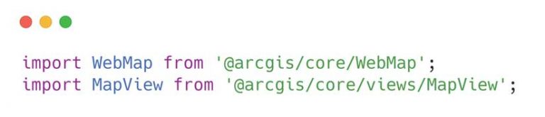

npm install @arcgis/core
Then use import statements to load individual modules. Note that the ES modules package naming convention uses /core rather than /esri, which is used by the AMD CDN modules, as shown in Listing 2.

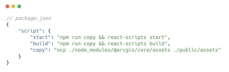

Copy Assets
You will need to copy the API assets (which includes styles, images, fonts, pre-built API web worker JS files, and localization files) from the @arcgis/core/assets folder to your build folder. A simple way to accomplish this is to configure a Node Package Manager (NPM) script that runs during your build process. For example, use npm to install ncp and configure a script in package.json to copy the folder. See the React example in Listing 3.

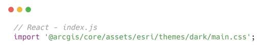

Configure CSS
The final step is to set up the CSS. Choose a theme and then configure your code to copy the theme files from @arcgis/core/assets/esri/themes/ into your project. Listing 4 provides a React example. Now you can run your build and the API’s ES modules will be bundled along with all your other imports.
