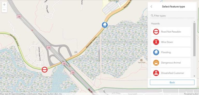

Feature Templates
Defined in the service, feature templates contain all the information required to create new features in each feature layer. This information can be the default attribute values with which a feature will be created and the default symbol for the feature. The Editor widget displays all feature templates for editable layers. The user can browse, filter, and search feature templates to find one suitable for the kind of feature they want to create.

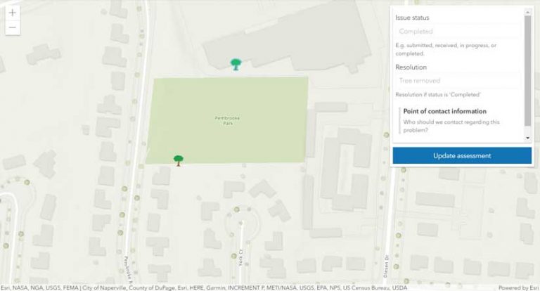

Determine When an Attribute Should Be Visible
Sometimes it only makes sense to edit an attribute based on a specific condition. For example, if your user is editing work orders, you should make the attribute describing the resolution of a work order visible once the work order has a completed status. Do this by writing a visibility expression for the field. After resolving to true, it will be displayed for editing.

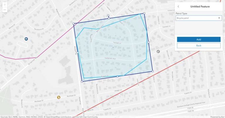

The editing tools in 4.x that allow you to create and update geometries are similar to tools in the 3.x version. However, 4.x lets the user undo and redo updates while the edit is in progress. For example, they can undo (or redo) the last vertex added while drawing the new geometry.
The end-to-end experience for creating and updating geometries is handled by the Editor widget, but you might want to customize it based on your editing workflow requirements. For example, you might want to display statistics about the geometry of a polygon being drawn. The Editor widget uses the Sketch widget’s business logic (referred to as SketchViewModel) to draw on the map.
You can use SketchViewModel to capture the map interaction events needed for executing your custom code during the drawing process. Your code can use the client-side geometry engine for testing spatial relationships, calculating measurements, or any other common spatial operation. The end user gets immediate feedback while drawing a polygon and can adjust it as necessary.
