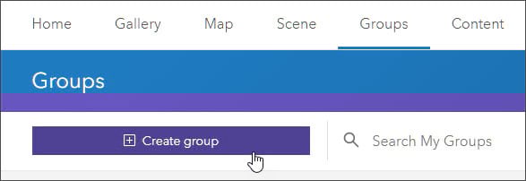

Step 1: Log in to your ArcGIS Online organization. From the Groups tab, click Create group.

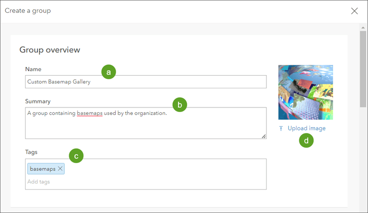

Step 2: Fill out the fields in the Group overview.
a. Add a group name.
b. Add a summary description for the group.
c. Add one or more tags.
d. Add a thumbnail for the group (optional, but recommended).
Leave the rest of the group settings as the default. Ensure that the group is viewable by Everyone (public) or by All organization members. Note that all maps in the group should be public.
Step 3: Click Save when finished.

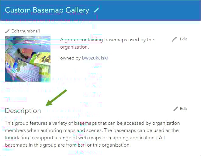

Tip: After the group has been created, it’s a best practice to complete the group description.

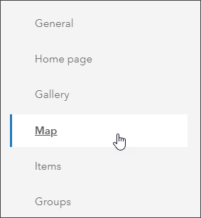

Step 1: Go to your organization’s Settings and open the Map tab.

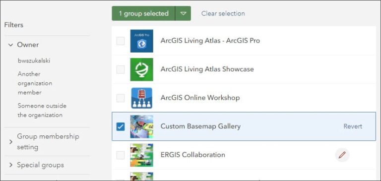

Step 2: In the Basemap gallery section, do the following.
a. Select your custom basemap gallery group from the drop-down list.
b. Click Share basemaps to add the default Esri basemaps to the group. This is optional, but if you only have a few custom basemaps in your custom gallery group, adding these will complete your gallery.
You’ve successfully created a custom basemap gallery, which will appear in all apps.
