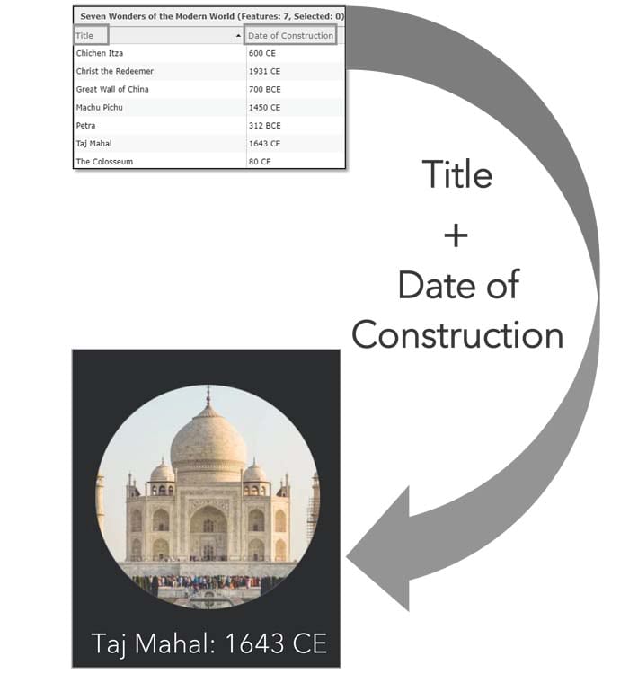

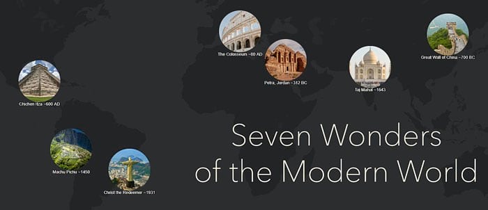

For example, this map visualizes the seven wonders of the modern world. There are two fields in the map’s layer: Title and Date of Construction. You will want to combine the data in these fields onto one label.

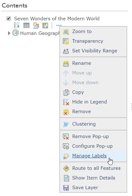

Step 2—Select the More Options symbol (the three dots under the layer name) and click Manage Labels in the drop-down menu. This opens the label editor, where you can customize your layer’s labels.

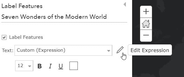

Step 3—Select the Edit Expression pencil symbol, to the right of the Text drop-down menu.

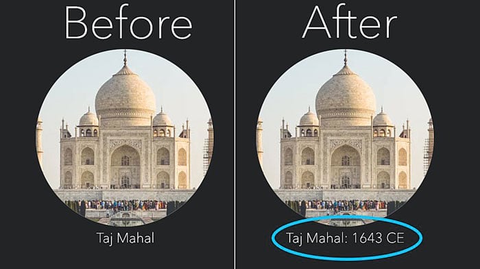

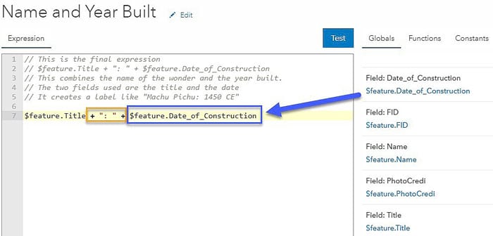

Step 4—Add the year of construction to the label to make it more informative.
To do this, type a plus sign, a colon in quotation marks, and another plus sign (+ “: ” +) to the right of $feature.Title. We use a plus sign because we’re adding words together. Make sure to add a space after the colon so that the labels are nicely spaced.
Now click the Date of Construction field, in blue ($feature.Date_of_Construction), which adds it to the editor.
Geospatial Techs Turn in the Sun
Click the blue Test button to see how your label will look. The Arcade expression combines multiple fields and returns a label like “Taj Mahal: 1643 CE”.
When you’re ready, click OK. Notice how the year now appears in your map.

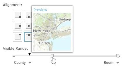

Step 5—Edit the label size, color, halo, and position to best match your map. The Visible Range slider determines when your labels appear. For example, click on the left side of the light gray slider bar and move the slider to the right of the black triangle (the map’s current zoom level). Notice how the labels disappear from the map. We use this feature when the labels no longer look good at certain scales (e.g., when zoomed out). Return the slider to the far left, the World scale.
