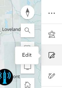

Step 2: On the light toolbar, click the Edit icon.

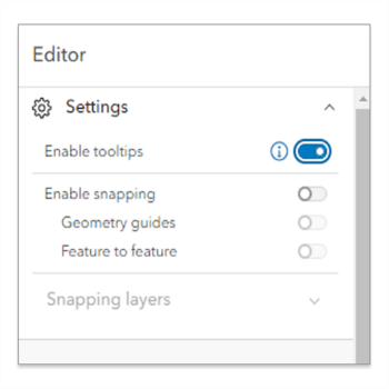

Step 3: Under Settings, click to enable tooltips.

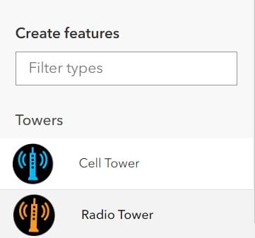

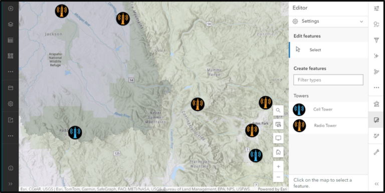

Step 4: In the Editor pane, under Create features, click the Radio Tower icon. The latitude and longitude of the cursor’s position are displayed as you move the cursor across the map.

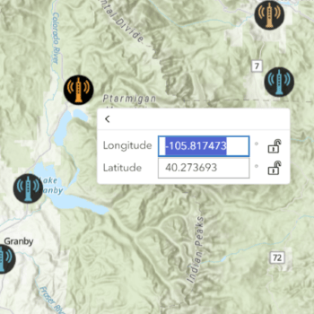

Step 5: Instead of clicking in the map to add a point, click the tab key on your keyboard to enable input mode. This allows you to type in information in the Longitude and Latitude fields. Clicking the tab key again allows you to navigate between these fields. You can also click outside the field to lock the entered coordinate in place.
Step 6: Type in the following coordinates:
  • For Longitude: -106.293570
  • For Latitude: 40.356250
Notice that the icon snaps to the given coordinate once the field is filled.

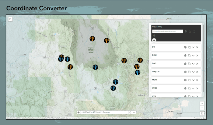

At this time, tooltips work best with decimal degrees (DD). If your coordinates are in a different format, the ArcGIS Experience Builder coordinate conversion widget is handy for quick conversion. Check out this simple app that features the widget. Just type in a set of coordinates or click the Add Point icon, then place a point on the map to see the coordinates converted into several different formats.
