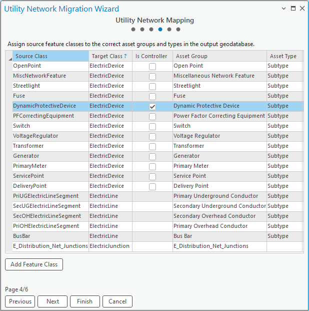

  • Electric – Electric networks are source-based networks. Distribution networks use circuit breakers as subnetwork controllers for each feeder. Power transformers inside a substation are also considered subnetwork controllers for all equipment at that voltage within the substation. Transmission networks use the substation equipment on either end of a transmission line as subnetwork controllers to manage tracing the transmission line. Learn more about electric utility networks.
Sample mappings for an electric utility network

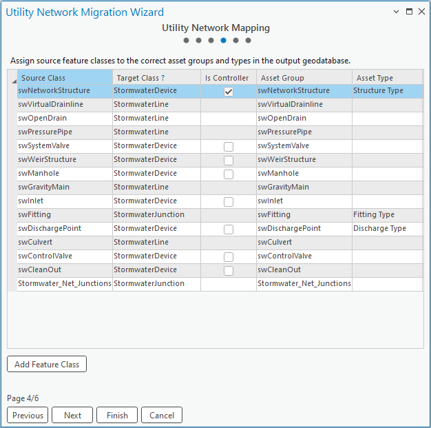

  • Stormwater – Stormwater networks are sink-based networks. Outfalls act as subnetwork controllers for a watershed area. If multiple outfalls share a common watershed area, then their subnetwork name should be the name of that common watershed area. A subsequent article will show you how to configure your utility network to subdivide your watershed area into separate catchments. Learn more about stormwater utility networks.
Sample mappings for a stormwater utility network

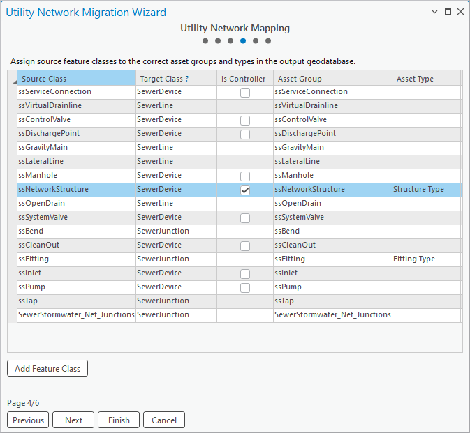

  • Wastewater – Wastewater networks are sink-based networks. The wastewater treatment plant, or other sinks, within your network should act as the subnetwork controllers for your sewershed area. A subsequent article will show you how to configure your utility network to model individual subbasins. Learn more about wastewater utility networks.
Sample mappings for a sanitary sewer utility network
