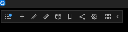

1. Find and click Basemaps and Terrain on the top menu
Toolbar

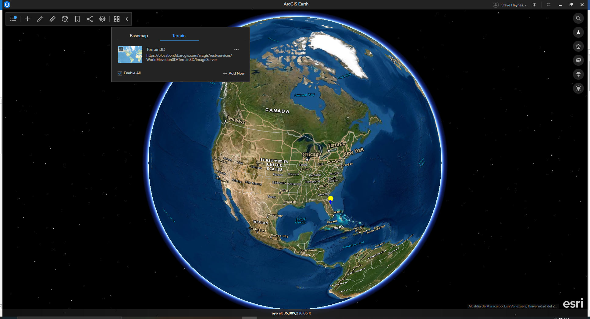

2. Once clicked, select the Terrain tab
Add new

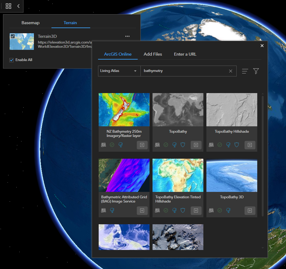

3. Click Add New to add additional terrain basemap resources to ArcGIS Earth. Under the ArcGIS Online tab:
      • Select Living Atlas
      • In the search window, type “bathymetry”
      • Locate and add the TopoBathy3d map layer
Basemap resource

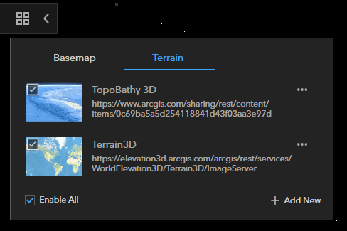

4. There should now be two terrain sources added to ArcGIS Earth
    • Make sure Enable All is checked
    • With these two terrain resources added, you should now be able to track elevation changes on land as well as the depth changes below sea level.

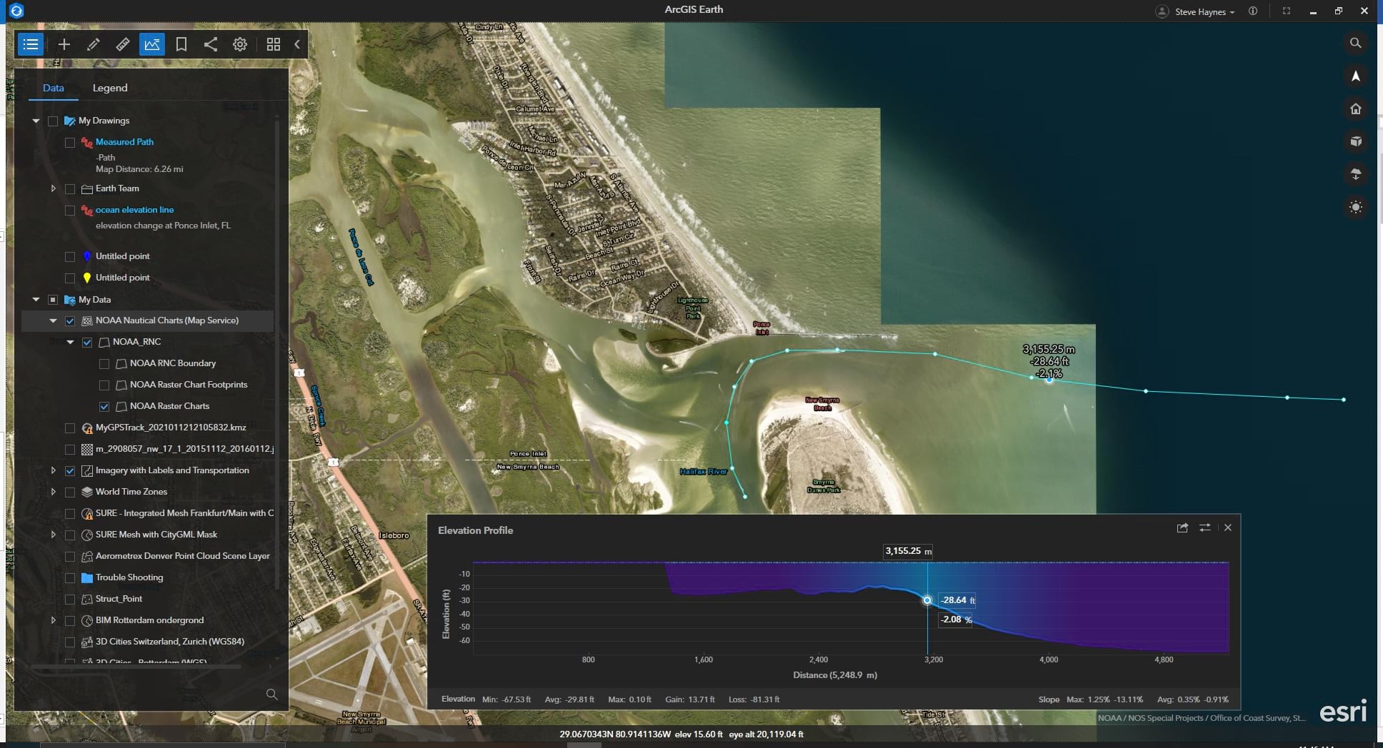

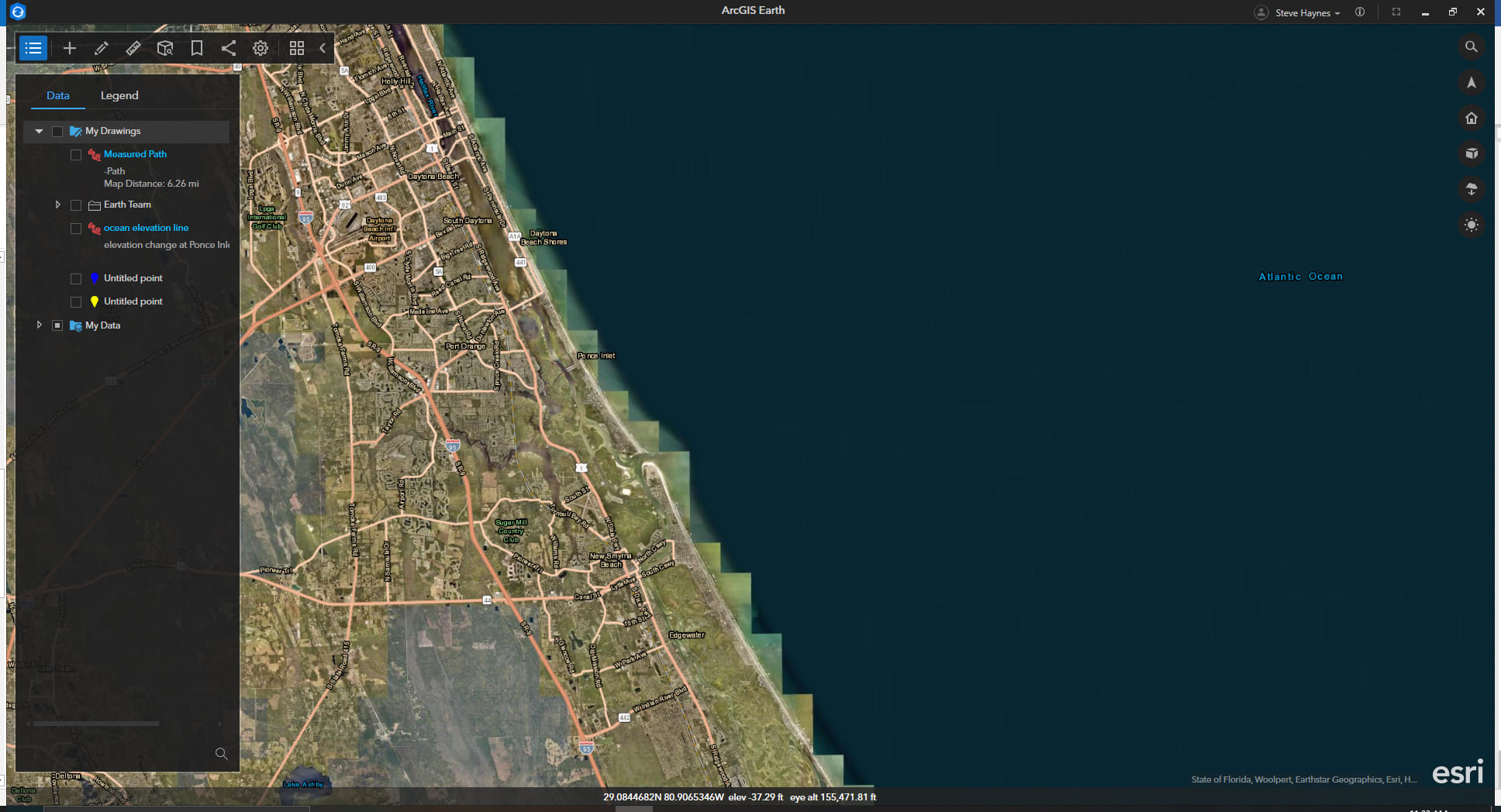

Terrain elevation above and below sea level can be analyzed and visualized in two different ways: the Explore Bar at the bottom of the window, and the Elevation Profile tool.

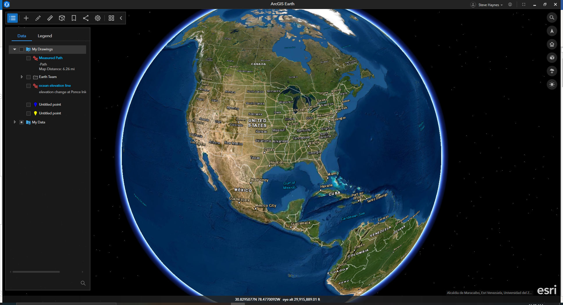

Explore bar mode with X,Y,Z auto-populated
1. When zoomed far out and your mouse is run over the globe surface, X,Y coordinates, and Eye altitude are shown on the explore bar as shown below:
2. When zoomed in below 200,000ft eye alt and your mouse is run over the globe surface, X, Y, Z coordinates, and Eye altitude are shown on the explore bar as shown below:
3. The Elevation Profile tool can be used for further investigation of the terrain below sea level.
