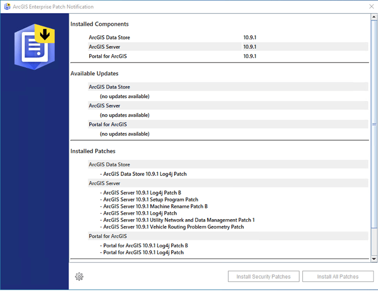

In addition to the Esri Support website, administrators can use the patchnotification utility that’s installed with each component of ArcGIS Enterprise on Windows and Linux.  The benefit of this utility is that it reports information on relevant ArcGIS Enterprise components based on your installed version automatically. For this utility to report available patches, the machine where each component is installed must have network access to https://downloads.esri.com/patch_notification/patches.json.  It should be noted that if you’re working in a disconnected environment, with no internet access, the patches will need to be downloaded and installed directly from the Esri Support website.
For the utility to download patches as necessary, the following sites to also be accessible to the machine where each component is installed:
The utility includes options to either install only security patches, or all patches.  Please note, while this process is automated the Enterprise components in question will be restarted multiple times throughout the process.  It is important to bear your organization’s service level agreement (SLA) in mind, and to ensure that patches are being installed during off-peak hours or during a maintenance window.
Image of the ArcGIS Enterprise Patch Notification utility.
The ArcGIS Enterprise Patch Notification utility is a handy tool to see what patches are available and installed in your deployment.
