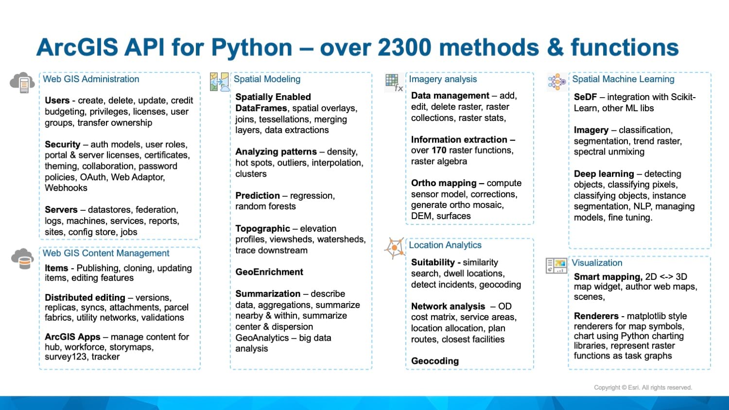

Python API - over 2300 tools
The ArcGIS API for Python has grown into a vast library with over 2300 methods and functions!
The picture above (presented at Python Libraries for Spatial Data Science talk) distills some of the key capabilities of the API. At version 1.8.3, we have tried to enhance each of these aspects and this blog is a rundown of the top features.

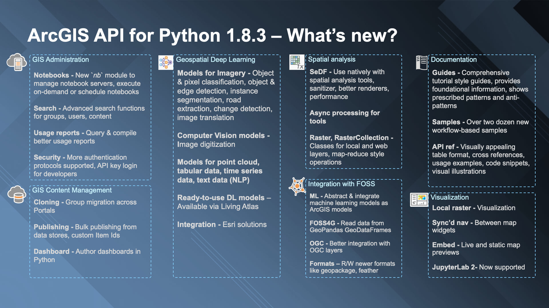

Wow! That was a long drive through the various modules of the API and I have only covered the key features. How about I leave you with a single slide overview of the above?
New features in v1.8.3 of the Python API - at a glance
