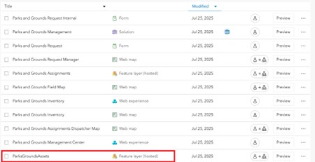

Let’s walk through an example of creating templates (including group and preset) within ArcGIS Pro using a solution available from ArcGIS Solutions.  I browsed the ArcGIS Solutions State and Local Government site and deployed the Parks and Grounds Management solution.  I chose this solution because it creates among other things, a hosted feature layer that I can use to demonstrate how to create and share editing templates.  After deploying the solution, I logged into my ArcGIS Online organization, and I could see the content that was created for me:
We will use the ParksGroundsAssets feature layer (highlighted in red at the bottom of the list) within Pro for creating our templates.

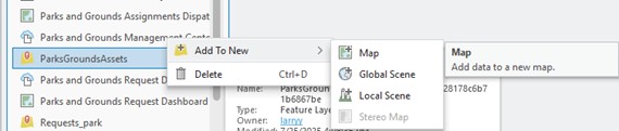

Moving to ArcGIS Pro, I can create a new project, connect to my ArcGIS Online organization, then use the ParksGroundsAssets hosted feature layer to create a new map.

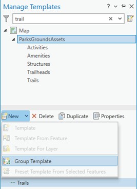

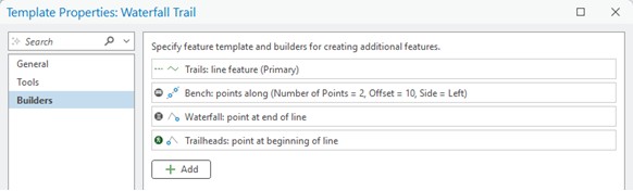

For our group template, let’s create a water trail template that consists of a trail line feature with a trail head at the start, a waterfall at the end, and benches along the way.  To create this group template, we will search for “trail” in the Manage Templates dialog, then right click on the Trails line feature that is returned and select the Group Template option.
With Trails as our Primary template, we can then create a group template consisting of a Trailheads feature at the beginning of the line and a waterfall feature at the end of the line.  We also want to have a couple of benches along the way, so we will also add that to the group template.  This template will be called “Waterfall Trail” with the Builders for the group template looking like this:

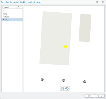

We also want to make use of preset templates, so we can follow the Pro help to create a preset template.  The preset template we want to use for this example will allow us to layout a parking lot, bathroom, and picnic table features with a single click.  The preview of this template in Pro looks like this:
As the image shows, the present template is called “Parking w/picnic tables”.

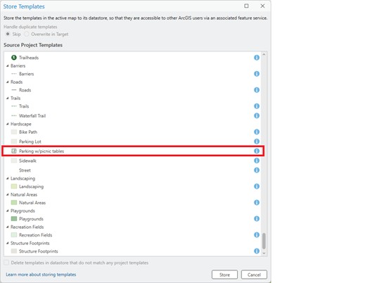

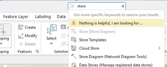

Now that we have some templates we want to use in web applications, we can use the Store Templates command in ArcGIS Pro to write the templates to our ArcGIS Online organization.  Begin by typing “store” in the search bar at the top of Pro to find the command.
You’ll see the Store Templates command as the first thing returned.  Drag and drop the command to any of your toolbars including the QAT (Quick Access Toolbar).  The command will write the templates to the tables in the active portal for your ArcGIS Pro session, so for this example I am logged into my organization account for ArcGIS Online.  The workflow is the same if you want to write your templates to an ArcGIS Enterprise database, you just need to make sure that is your active portal in Pro and your map consist of data coming from a feature service from that portal before using the command.  Click on the command and you will get a dialog for specifying which templates you want to write to Online.
The preset template I created is highlighted to show it is part of the list of templates that will be writing to Online.  After hitting the Store button, we are ready to use our templates with the Online applications.

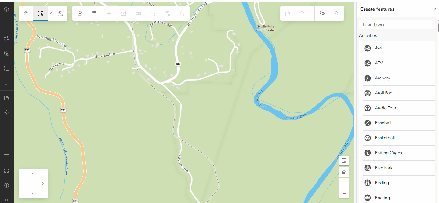

Going to start with the new Web Editor application available for both ArcGIS Online and ArcGIS Enterprise.  First step with Web Editor is to open an existing web map.  The Parks and Grounds Management solution includes not only data but web maps as well, so we will open the Parks and Ground Inventory web map created when we downloaded the solution.  We also could have authored a new web map from ArcGIS Pro after creating the templates, but for this example we will use the web map the solution gave us.
With the web map open we will zoom to a location I know well in the foothills of North Carolina, where I know there are some waterfalls.  In Web Editor we will use the Create Feature dialog to search for and then use the templates we authored in ArcGIS Pro.  We will start by placing a parking lot and picnic tables.  At the top of the Create Features dialog I can search for “parking” and select our Parking w/picnic tables preset template.

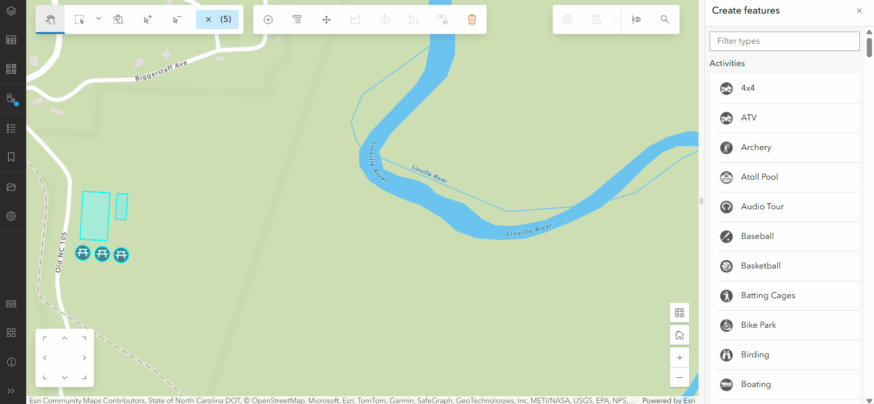

With one click I can place the parking lot, bathroom and picnic tables just off road.

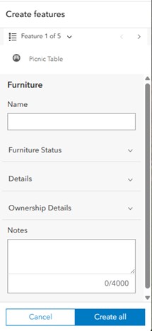

After clicking on the map to place the features, the Create Features dialog tells me 5 features will be created and gives me the option to update attribute values before completing.
After entering the required attributes for my features including facility names and building types, I can click on the “Create all” button to complete the process
