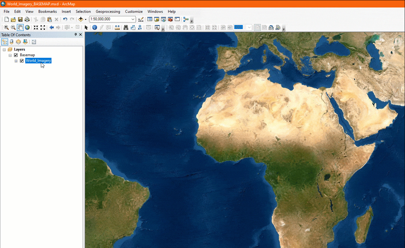

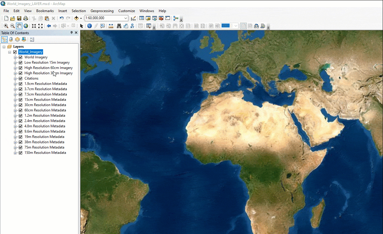

If raster basemaps were added from a server connection as a layer (i.e. they were not added from the Basemap gallery), go to the Layer Properties and open the Source tab to determine if the connection is using HTTP or HTTPS.
.gif demonstrating how to use the Layer Properties dialog to check if the raster basemap's source is HTTP or HTTPS.
If the Server property is using HTTPS, no action is needed.
If added from the Basemap gallery, the layer will be part of a Basemap group and the source properties will not be exposed. Move it out of the basemap group in order to see its source properties.
.gif demonstrating how to move a layer out of the basemap group to check its source properties to determine if it is using HTTP or HTTPS.
If the Server property is using HTTPS, no action is needed. You can move the layer back into the Basemap group to optimize performance.

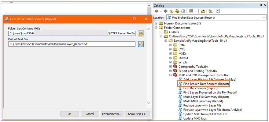

  1. Go to SampleArcPyMappingScriptTools_10_v1 and download the zipped files.
  2. Extract the files.
  3. Create a folder connection to the SampleArcPyMappingScriptTools_10_v1 folder.
  4. From the MXD and LYR Management Tools.tbx, open the Find Broken Data Sources (Report) tool.
The find broken data sources (report) tool is part of the MXD and LYR Management toolbox

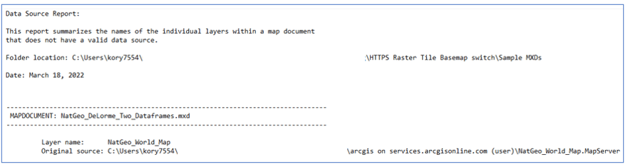

The tool will generate a report of .mxds containing broken layers that you can inspect further.
Example report from running the Find Broken Data Sources (Report) tool
Because Find Broken Data Sources (Report) is a script tool, it can be used as a starting point and be modified to customize checks.
