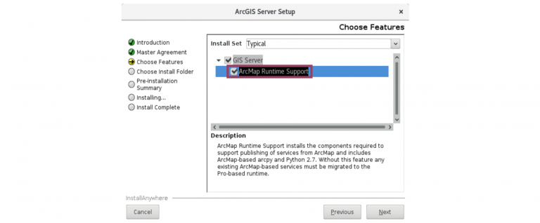

In Linux, you can disable or enable ArcMap Runtime Support and remove Python 2.x after installation using the modify_AMRS.sh script located in the ./Support folder of your ArcGIS Server 10.9.1 installation.
Screenshot of how the ArcMap Runtime Support feature can be disabled in Linux.
Disabling the ArcMap Runtime Support feature in Linux.
