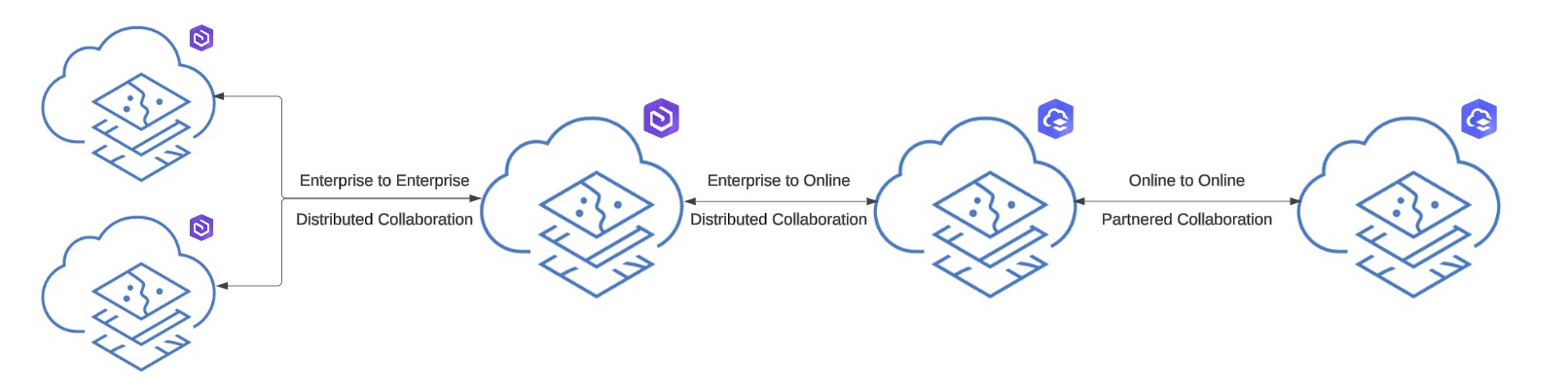

When setting up collaboration between ArcGIS Enterprise deployments, consider who the host should be and who should be the guest. The host initiates the collaboration, defines the workplaces, which guests are invited, how content is shared and access. The guest controls the sync schedule and runs the synchronization jobs as well. This means it’s important to consider the performance impact of being the guest in collaborations with multiple workspaces – those synchronization jobs can add up and, depending on resources available, may impact the performance of your Enterprise deployment.
When setting up a collaboration between ArcGIS Enterprise and ArcGIS Online, ArcGIS Online will always be the host. Do note that ArcGIS Enterprise can only participate in a collaboration with one ArcGIS Online organization – and that is by design. Content can be shared with multiple ArcGIS Online organizations using a combination of distributed and partnered collaborations instead! Share content from the ArcGIS Enterprise to the main ArcGIS Online organization via distributed collaboration first. Then share the content from the main ArcGIS Online organization to other ArcGIS Online organizations via partnered collaboration.
Diagram of ArcGIS Enterprise and ArcGIS Online set up with distributed collaboration and ArcGIS Online set up with another ArcGIS Online via partnered collaboration.
Content can be shared from ArcGIS Enterprise to ArcGIS Online via distributed collaboration, and then from ArcGIS Online to another ArcGIS Online organization via partnered collaboration.
