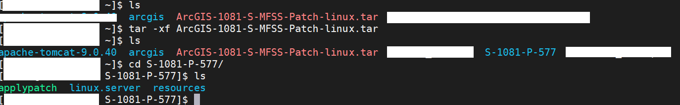

Once we download the patch and transfer it to our Linux machine, we should see something like the following:
Once done, we will need to extract the *.tar file and navigate over to the applypatch. See below:

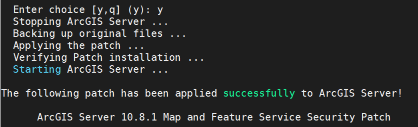

Once the applypatch script has been invoked, a stream of information will be presented before you. You have the option to review before agreeing to apply the patch. If all looks okay, press ‘y’ to apply the patch:
All done, the patch has been successfully applied!

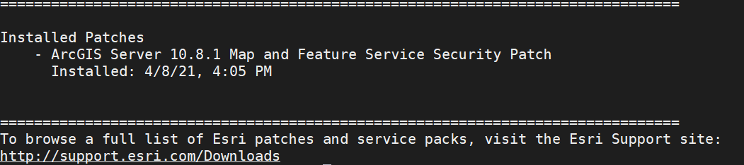

We can verify that the patch has been installed using the patchnotification tool. Navigate over to <ArcGIS Installation Directory>/arcgis/server/tools/patchnotification and run the patchnotification tool in console mode. Below, I have an example:
At the bottom of the output, there will be an installed patches section. If successful, we should see the newly applied patch:
