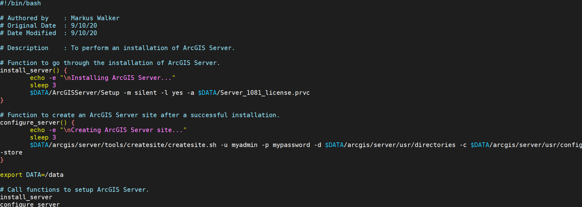

In the above user story, Bash would be a great choice to get up and going with automated ArcGIS Server installations. Below, here is a simplified Bash script named createAGS.sh that Joe might use:
In a realistic scenario, this script will be more comprehensive and not make assumptions about the system (as well as a better username and password). Looking past that, we see that the install_server function is calling upon the Setup script to install. Similarly, we see that the configure_server function utilizes the createsite.sh script to create the ArcGIS Server site.
This bash script by itself can be used throughout each of Joe’s QA and development machines and eliminates manual effort. However, to take it a step further, Joe can additionally utilize cron scheduling to fully automate.
