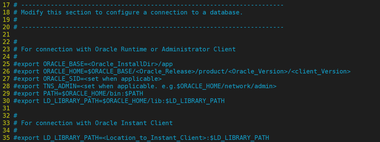

1. Understanding the init_user_param.sh script
Inside the ArcGIS Server installation, there exists a file known as the init_user_param.sh script. You can locate it here: <ArcGIS Server installation directory>/arcgis/server/usr/init_user_param.sh.
This script is used when you wish to override environmental variables that directly impact the ArcGIS Server startup process. There are preset environmental variables you can override, or you have the option to provide user-defined variables.
2. Configure Oracle Instant Client Connection
Navigate to the above specified directory and edit the init_user_param.sh script. Keep going until you see the following:
Take notice of line #35; that is what we will be modifying. Should you use an Oracle Instant Client to establish a database connection, perform the following:

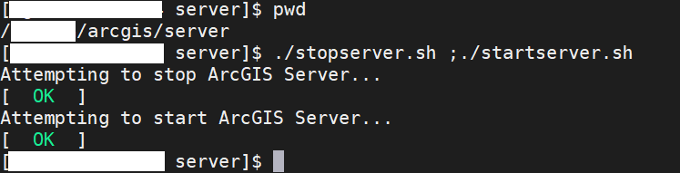

As seen, all we have done is uncommented line #35 and specify the path where the instant client folder exists. After that is done, save the file and restart ArcGIS Server:

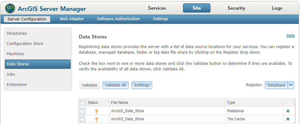

3. Register an Oracle Database in Server Manager
Now that we have successfully configured our Oracle database connection, we can test out registering a database! In a browser, navigate over to your Server Manager and over to the Data Stores tab:
Once there, attempt to register your Oracle database. If successful, it should register and validation will indicate a green checkmark as shown below:
