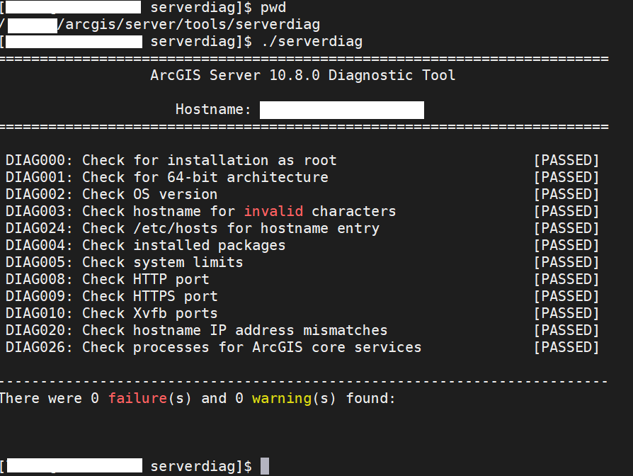

ArcGIS Enterprise on Linux comes with helpful diagnostic check tools that can be ran. These checks are the same checks that are ran at initial installation time. See below for ArcGIS Server’s serverdiag tool:
Portal for ArcGIS and ArcGIS Data Store have similar tools named portaldiag and datastorediag, respectively. Often times, system administrators may have a need to change the hostname of a machine. Portal for ArcGIS, in particular, is heavily reliant on the hostname used during installation time. One issue that some ArcGIS Enterprise users face is a change in a machine’s hostname causes published services to no longer be accessible. If proper precautions are not taken before the hostname change, this issue can escalate quickly. These built in diagnostic scripts can help determine if the hostname indeed is an issue.

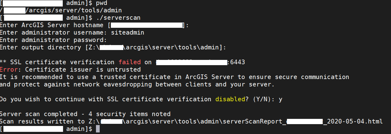

In Windows and Linux, there additionally is an admin tool for ArcGIS Server known as serverscan. As the name implies, this Python script runs a scan on your ArcGIS Server site.

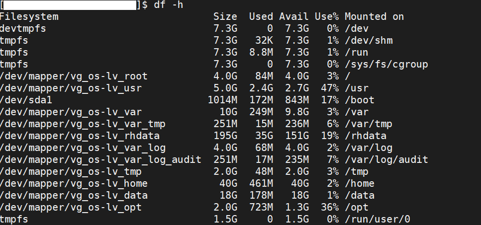

Let’s take a look at the first command, df -h:

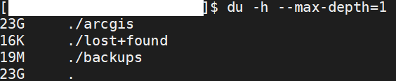

The df (or disk free) command reports the system’s disk space usage. The ­-h flag prints the disk space usage in human-readable form. Additionally, we can drill down the disk space usage into specifics of files and directories as shown below with the du command:
du (or disk usage) is similar to df, but differs in that it estimates the file space usage. The max-depth=1 flag shows the estimated size for every file and directory in the current working directory.

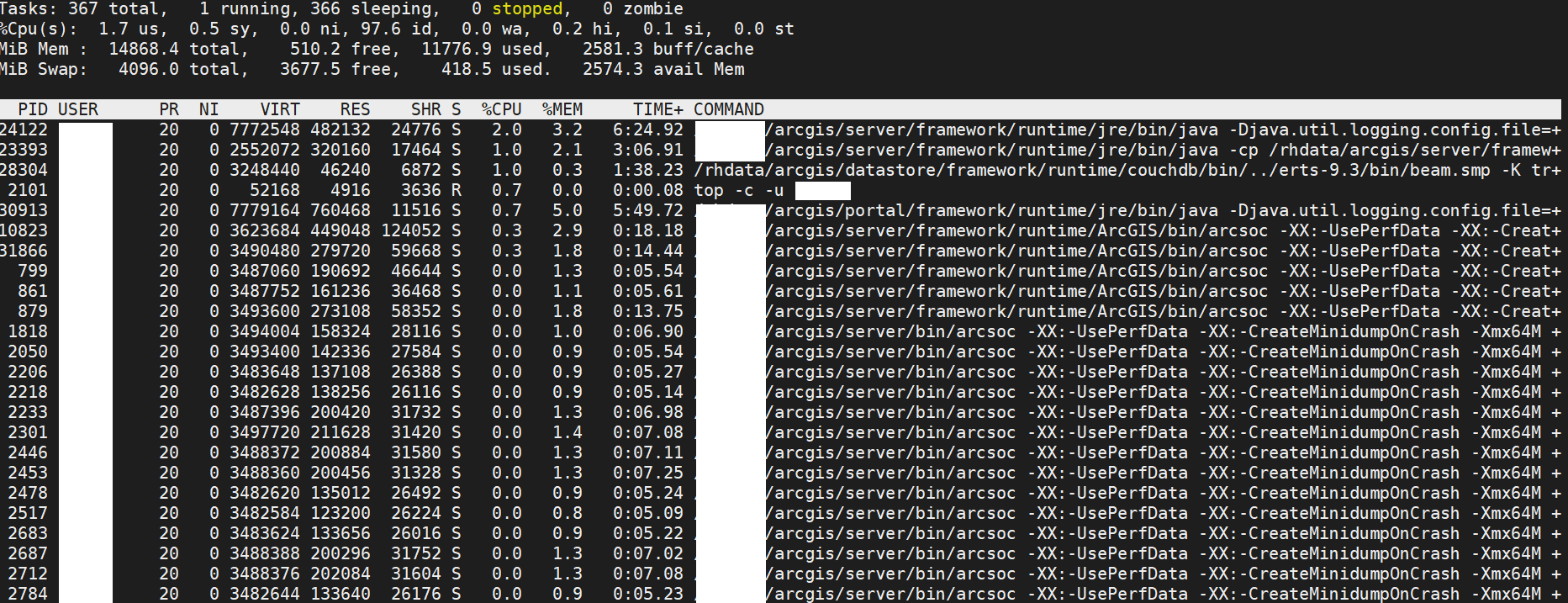

It’s not enough for a system to be up and running; it must also have optimized performance. When considering performance, the top command is usually the first command that comes to mind. For comparison to Windows, top is the equivalent to Window’s Task Manager to get a dynamic viewing of processes.
Specifically, when working with ArcGIS Enterprise, a helpful manipulation of the command is top -c -u <ArcGIS Installation User> (i.e. top -c -u arcgis):

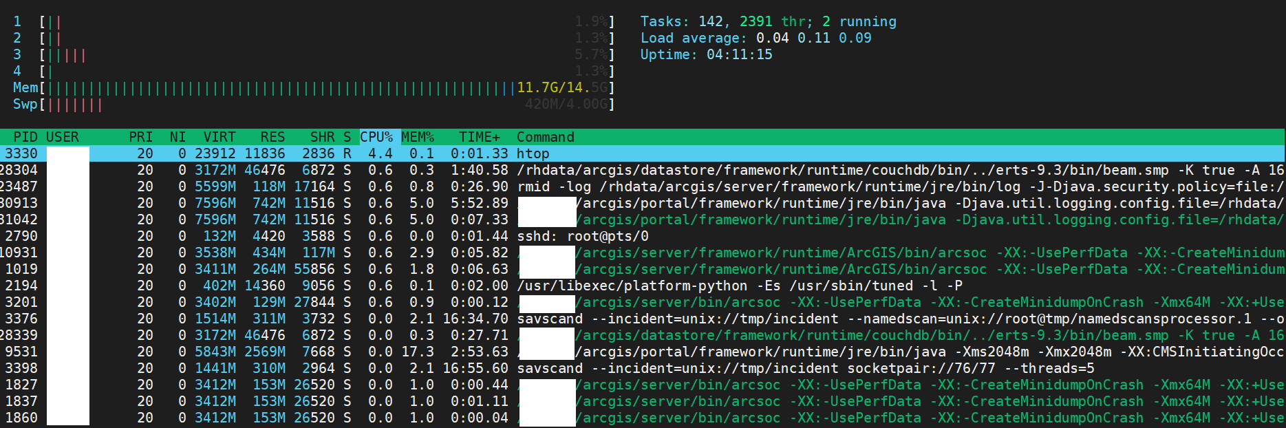

If any component of ArcGIS Enterprise appears to not be running, the top command is the first command to run to verify. A fancier version of top comes in the form of htop:

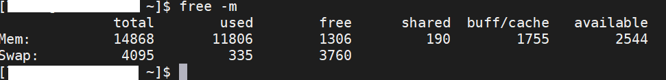

We discussed disk space’s place at the table, but memory must also have a seat in this discussion. In a nutshell, the free command displays the amount of free and used physical and swap memory in a system. See below for the free and used memory in MB format:

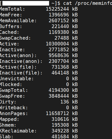

Shown above, the memory and swap are shown with helpful information. Free filters the above information by parsing the file /proc/meminfo. Running cat /proc/meminfo will give the system’s full memory information:
Note: The above photo is a snippet of the full cat /proc/meminfo command.

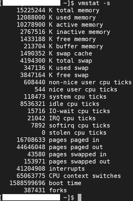

Virtual memory statistics are important for a sysadmin as they tell information on processes, memory, CPU activity and disks. As with free, the common method of checking virtual memory statistics is with the command vmstat -s as below:
