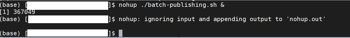

The above example is great, but we desire more. We need to be able to place this in the background while we work on other important tasks. Luckily, nohup offers that flexibility as well. We can simply modify the above example to show the following:
Simply adding the & sign at the end places our task in the background! Notice that immediately following is the PID associated with this command. As this command is in the background, you can press ‘Enter’ on your keyboard and let the command play out.
As with before, you can track the progress inside the nohup.out file. Additionally, as this is in the background, using the fg command, you can bring the nohup back into the foreground.
