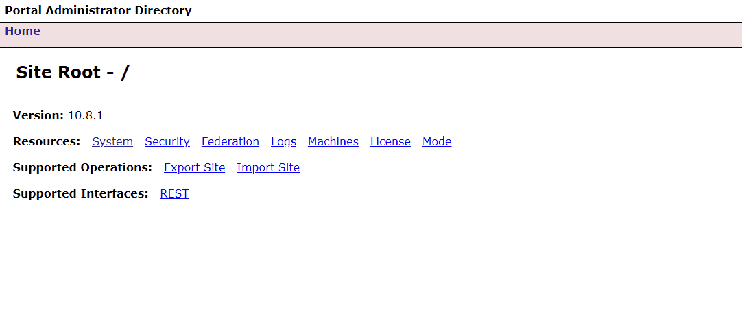

Step 1: Navigate to the Portal Administrator Directory
In 10.8.1, to configure your Enterprise portal to send emails navigate to the Portal Administrator Directory.  Log in as a member either assigned the default administrator role or as a member assigned to a custom role which includes the Security and Infrastructure privilege.

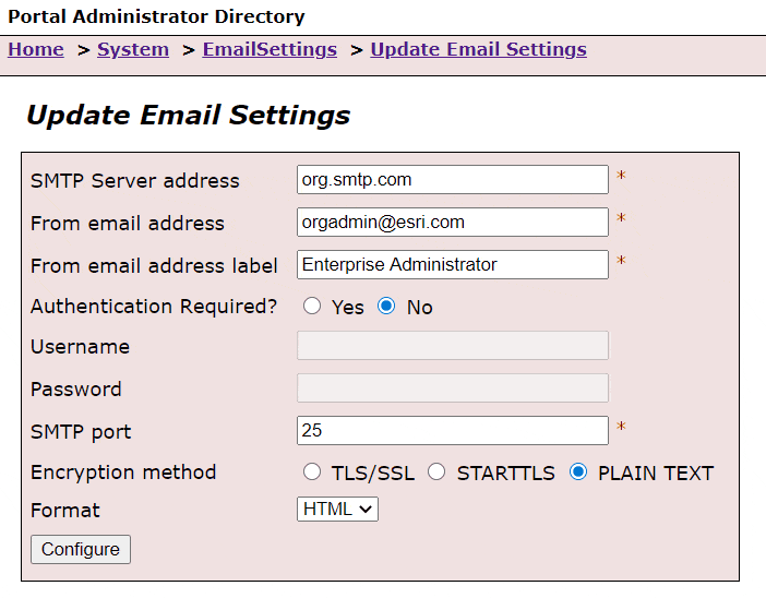

Step 3: Enter in your SMTP connection details
Click on the Update operation.  You will be presented with several parameters that you must specify to connect to your SMTP server.  You may need to work with your IT administrative team to retrieve this information.  You can find more details on each of these parameters here Email Settings REST API documentation.  Once you have filled in these parameters to connect to your SMTP server, click Configure.
Configuring the email settings
Configuring the settings to connect to your organization's SMTP server.

  • The port your SMTP server is communicating through is open for the Enterprise portal.
  • If your SMTP server is using encryption, ensure the Enterprise portal trusts the certificate.
  • The fromEmailAddress should be an account that is authorized to connect and send emails  to the SMTP server.
