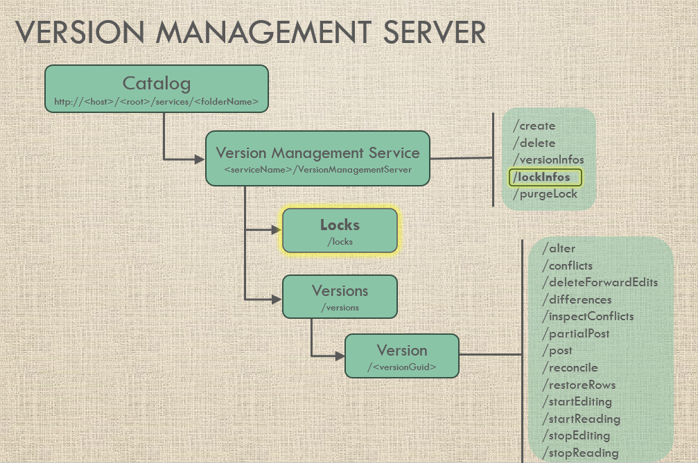

If you need more info about a version lock or want to view multiple locks on a version, the locks/lockInfos endpoints is exactly what you need – keep in mind that your ArcGIS Enterprise must be 12.1 or later to support this capability.
Capabilities
Take a look at the root of the Version Management service – you’ll notice there is a new capability of `supportsLockInfos` for the ArcGIS Enterprise 12.1 release. This capability indicates support for the following endpoints that provide details on version locks for a service:
  • locks resource
  • lockInfos operation
New endpoints – locks/lockInfos
Let’s dive into these endpoints a little more, so you can get familiar with them.
Locks resource
The locks resource represents all the locks on versions in a version management service that the current user has access to. This is a straight forward way to check locks that exist for the VMS that does not provide any filtering.

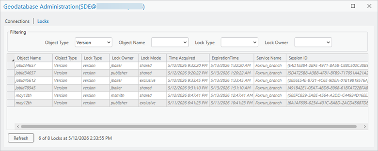

Version locks via Geodatabase Administration dialog
Outside of the REST API, you also have the ability to view many types of locks in ArcGIS Pro using the Geodatabase Administration dialog. To access this dialog, you’ll need a database connection that is established by the geodatabase administrator. In the Geodatabase Administration dialog, version locks can be viewed on the Locks tab by filtering using a Lock Type of Version. Since this dialog represents locks for the entire geodatabase, also take note of the Service Name column when reviewing.
