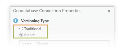

Before registering as branch versioned, you need to ensure that your database connection in ArcGIS Pro is explicitly set to Branch for the Versioning Type. You can do this in two ways:
  • Run the Update Geodatabase Connection to Branch geoprocessing tool.
  • Right click on your database connection, open the geodatabase connection properties, and change the Versioning Type option to Branch.
