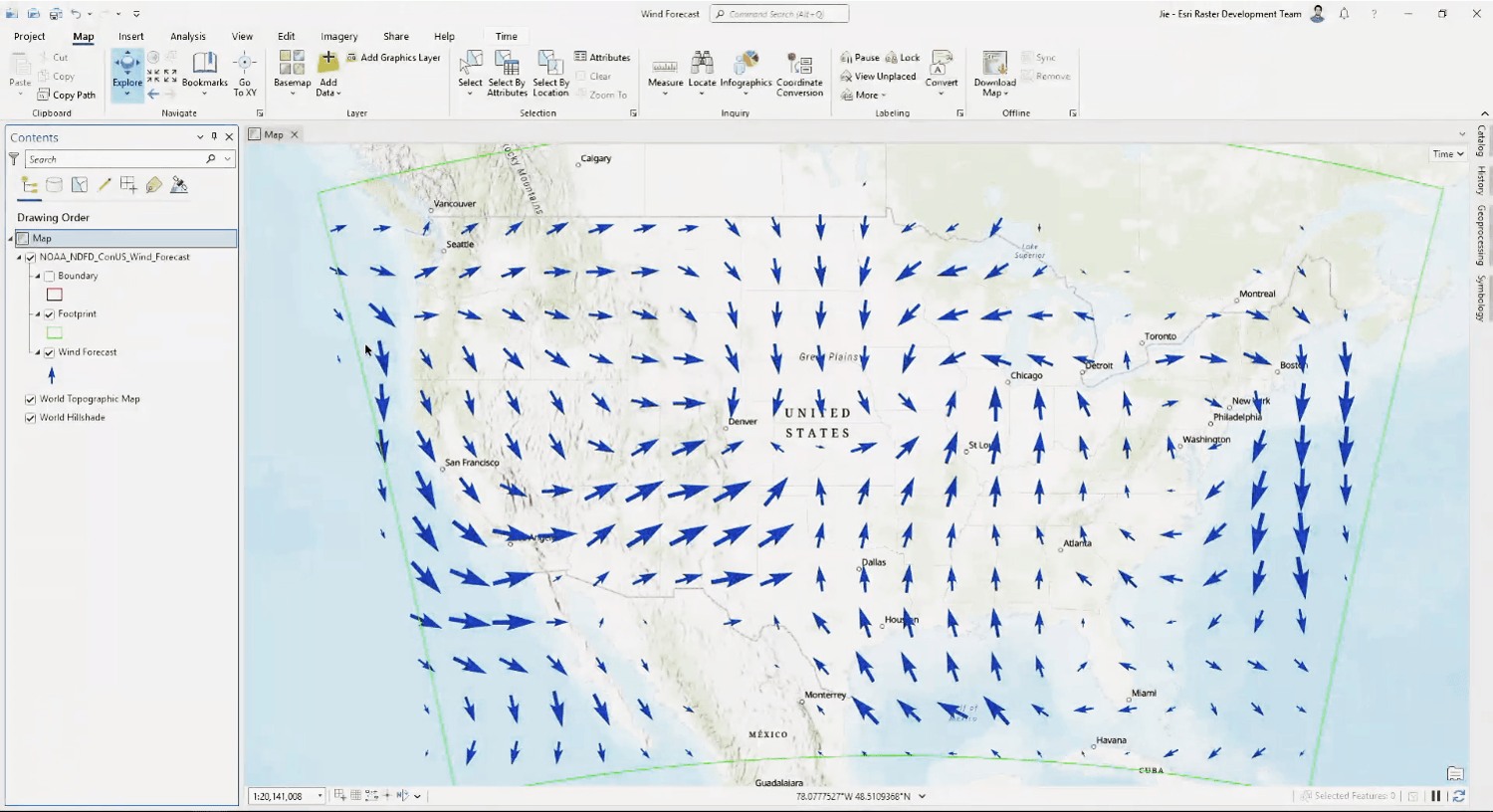

For this demonstration, Jie created an image service published from mosaic datasets. The mosaic datasets reference live, cloud-based weather forecast data for the continental United States. Specifically, the mosaic datasets reference wind forecast data, which contains information such as wind direction and speed values. These values can be interpolated by ArcGIS Enterprise and then visualized using vector symbology.
Figure 1: An example of how vector symbology is used to visualize wind speed and direction data in ArcGIS Pro.

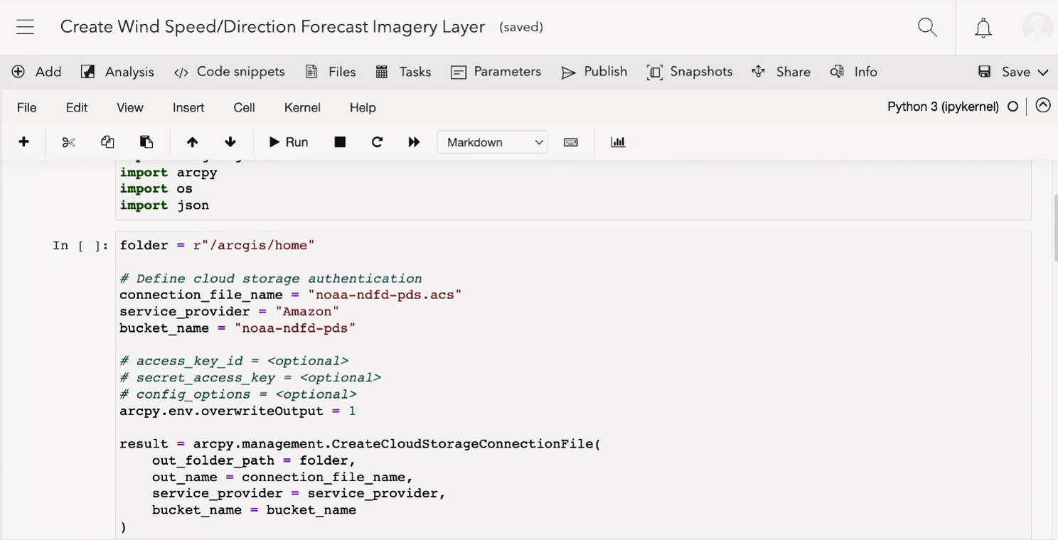

Jie’s first script has three main steps to create his image service. First, his script creates the cloud storge connection file that points to NOAA NDFD’s public S3 bucket.
Figure 2: An script in ArcGIS Notebooks. This specific step in the script creates a cloud storage configuration file.

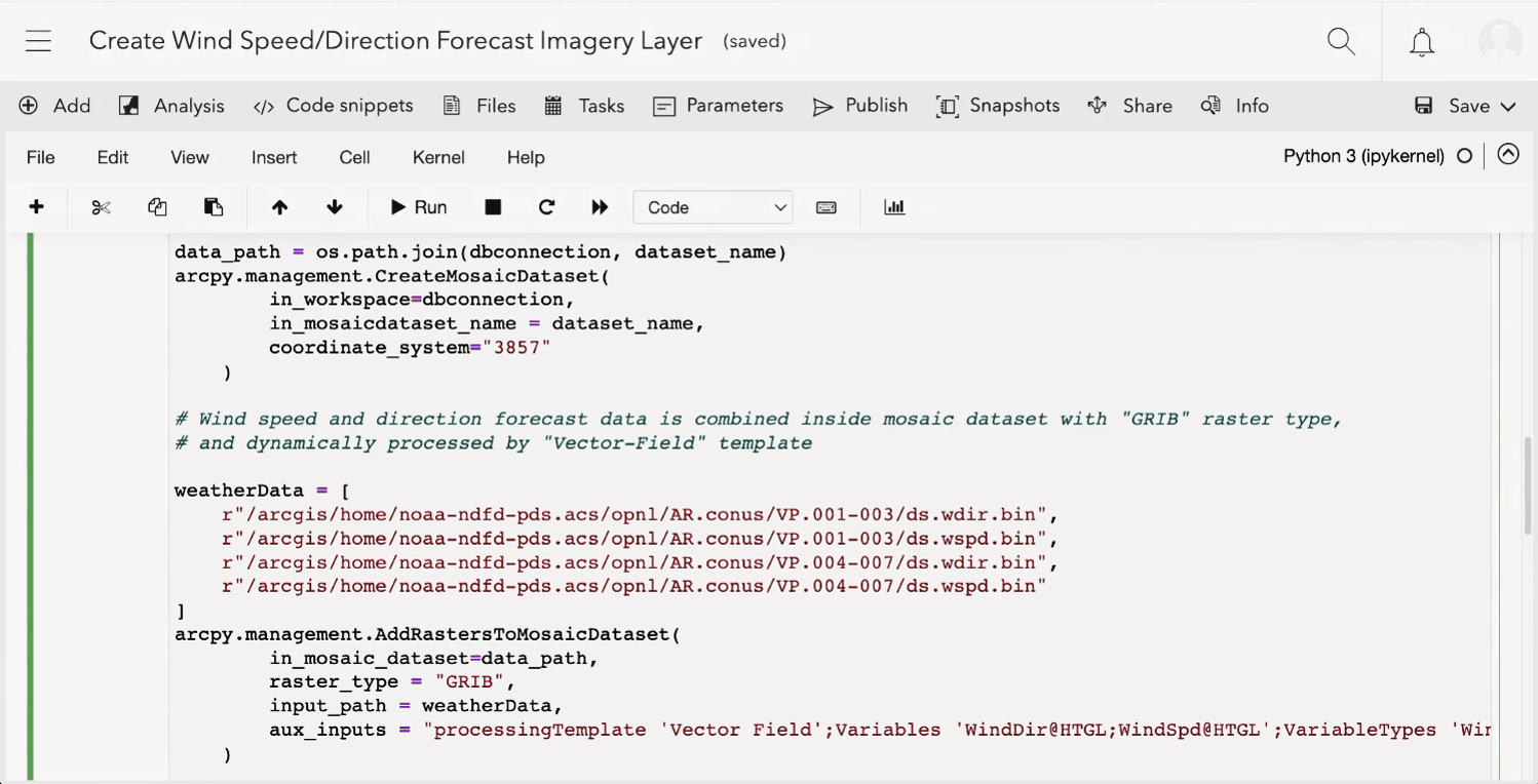

Once a connection has been established, his script creates the mosaic dataset that references the wind forecast data by calling the Create Mosaic Dataset and Add Raster to Mosaic Dataset tools. Because Jie’s script created a cloud storage connection file, this step will only reference the data, rather than copying it to ArcGIS Image Server.
Figure 3: A script in ArcGIS Notebooks. This step of the script creates a mosaic dataset that references public weather forecast data.

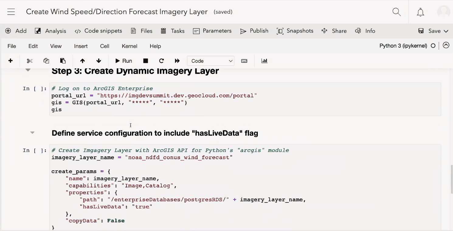

Finally, the script creates the image service using the ArcGIS API for Python Create Service method. Since his service is referencing live data, the service has the live data flag enabled.
Figure 4: A script in ArcGIS Notebooks. This step of the script that creates an image service that has live data.

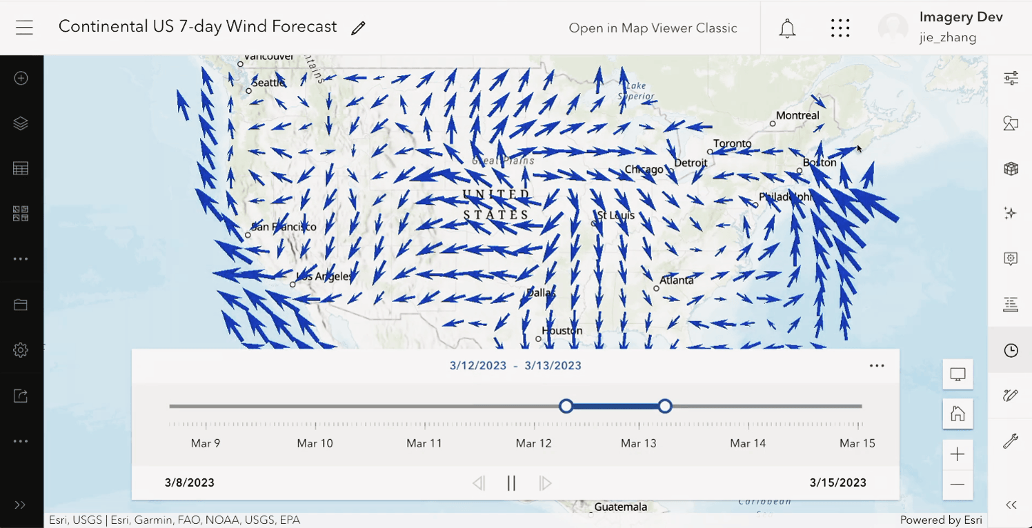

Jie shows us his result imagery layer, which has the most recent 7-day wind forecast data. Now that Jie’s created his image service, he needs to keep its data references up to date.
Figure 5: A imagery layer showing the most-recent, 7-day wind forecast data.

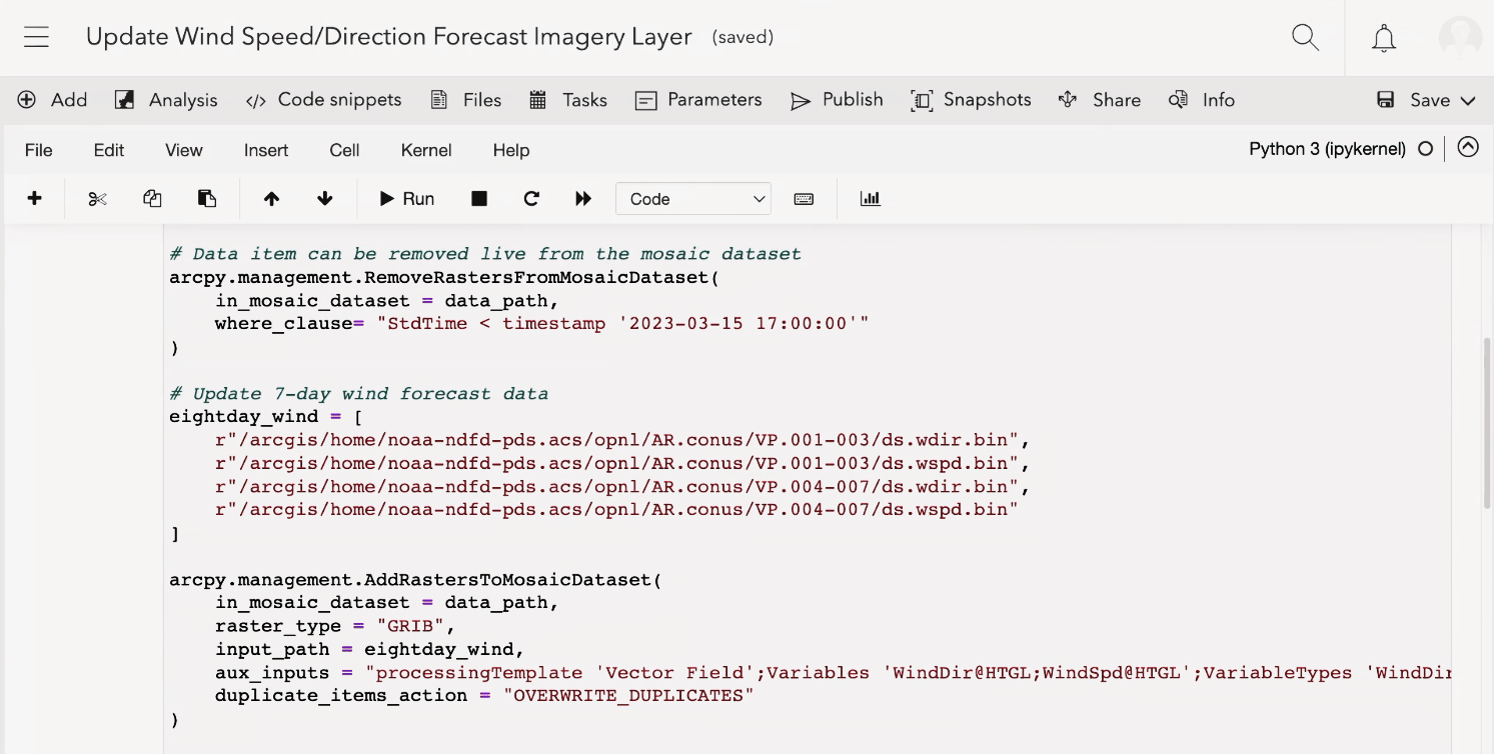

  • It removes the references to outdated data
  • It adds new references to the updated data files from NOAA NDFD back into the mosaic dataset
These steps refresh every forecast data slice’s timestamp and moves the entire forecast window forward one hour.
Figure 6: A script in ArcGIS Notebooks. This script updates the references in a mosaic dataset to use the most recent forecast data.

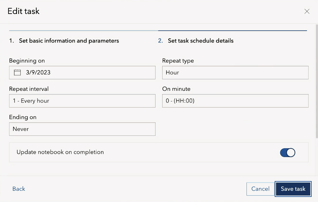

Jie also creates a task to run his notebook every hour, which will keep his image service up to date with the latest forecast data.
Figure 7: A scheduled notebook task. The task runs the notebook every hour.
