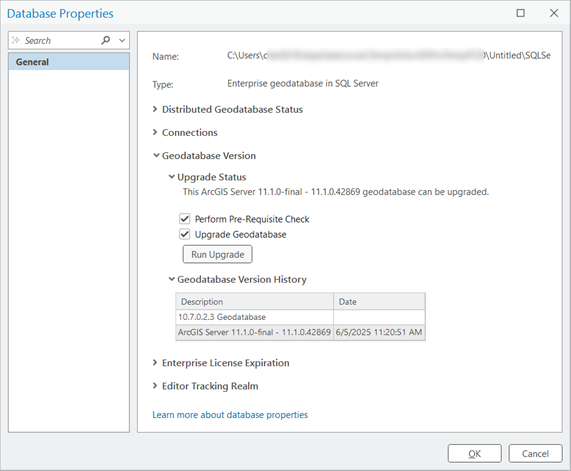

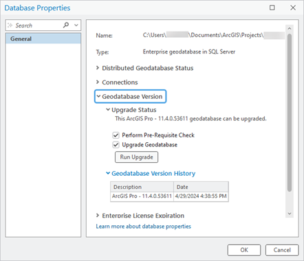

Check if the geodatabase can be upgraded from the ArcGIS client software
After installing a new ArcGIS product version, review the Database Properties settings as the geodatabase administrator by clicking Database Properties > Geodatabase Version > Upgrade Status. This displays the current geodatabase version and whether an upgrade can be performed.
Note: Starting with ArcGIS Pro 3.1 and ArcGIS Server 11.1, the geodatabase administrator can review the prior versions of the geodatabase along with the upgrade date by accessing the Geodatabase Version History section on the Database Properties dialog box.

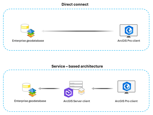

As previously mentioned, you must maintain the version of your enterprise geodatabase at the same release as your ArcGIS clients. But how do you know which ArcGIS client matches your geodatabase version? The answer depends on your workflow.
The above diagram shows the possible client environments for accessing enterprise geodatabase data sources:
- Client/server, also known as direct connect, refers to an environment in which the ArcGIS Pro software is the main client interacting directly with the enterprise geodatabase through a database connection. This is commonly referred to as direct connect.
- Services refers to an environment in which the enterprise geodatabase data is accessed from a service. These services can be accessed from ArcGIS Pro, web maps, or apps with an ArcGIS Enterprise portal.
After identifying the type of environment you are working in, you can understand where the geodatabase upgrade must be performed. The following example can help you identify the correct ArcGIS client to perform a geodatabase upgrade.
Upgrade a geodatabase from a client/server environment
If your organization uses editing workflows in which you are connecting directly to the database through a database connection (for example, workflows with traditional versioned data), the geodatabase upgrade can be performed by any client. Typically, in this example, the most common client to perform an upgrade from is ArcGIS Pro.
After updating your ArcGIS Pro client to the desired version, use the Upgrade Geodatabase tool or a Python script. This will upgrade your geodatabase to match the release of ArcGIS Pro.
For instance, an organization that has recently upgraded its ArcGIS Pro client from 2.9 to 3.1 will use the Upgrade Geodatabase tool as the geodatabase administrator. When the geodatabase is upgraded in ArcGIS Pro, the resulting geodatabase version is 11.1.0.41833. You can see that the geodatabase version number uses a combination of the corresponding ArcGIS Enterprise release number (for example, 10.x or 11.x) and a unique build number, typically composed of five digits (for example, 41833).

Upgrade a geodatabase from a service-based environment
If you are working in a services-based editing environment (for example, workflows with branch versioned data) you can perform the geodatabase upgrade in ArcGIS Enterprise. This is particularly beneficial when the geodatabase version is older or at the same release as the ArcGIS Enterprise version.
Perform a geodatabase upgrade in ArcGIS Enterprise
When installing an ArcGIS Server Utility Network and Data Management Patch, for example, you must perform the geodatabase upgrade in ArcGIS Enterprise.
In service-based architectures, the ArcGIS Enterprise software components are considered the client that connects directly to the geodatabase. In this type of environment, it is recommended that you keep the ArcGIS Enterprise client at an identical release to the geodatabase version.
