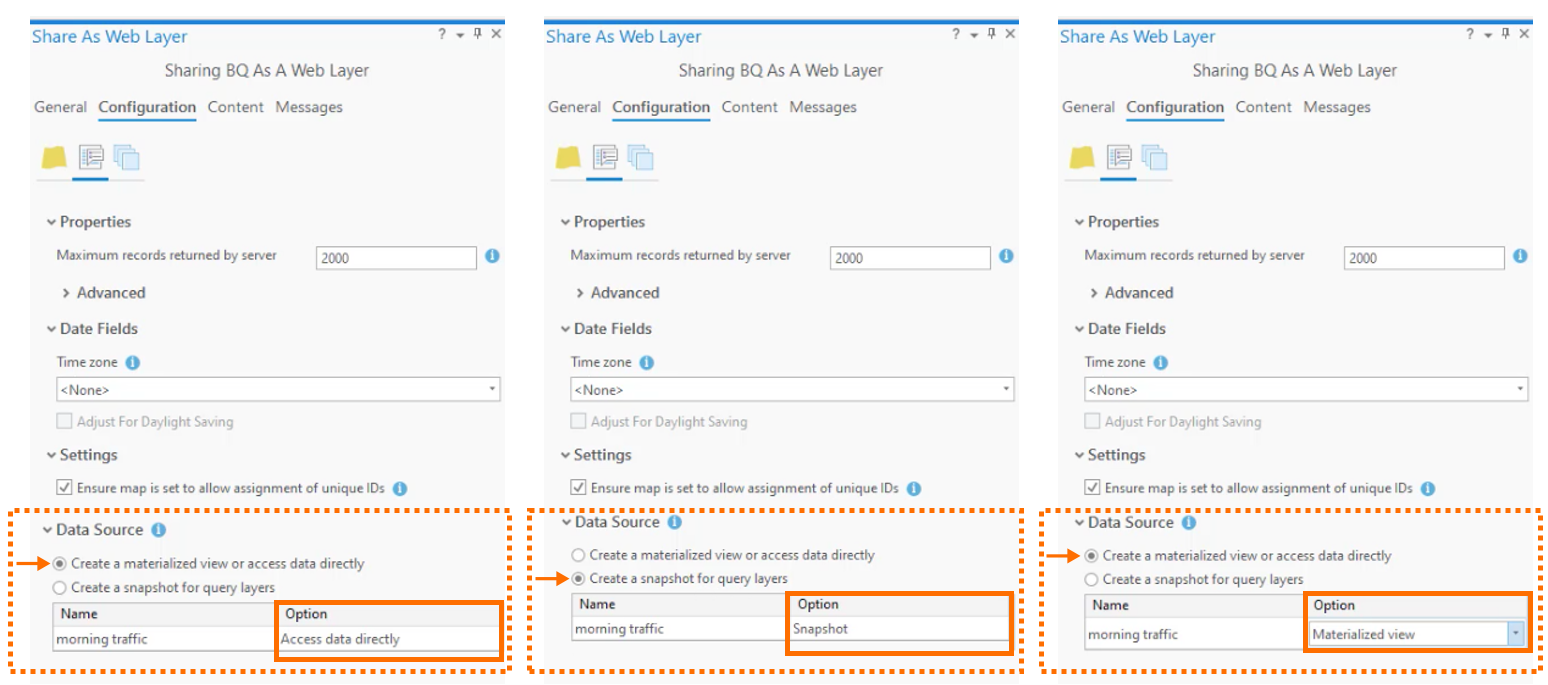

Once registered, the cloud data warehouse data can be published to the hosting server as a map image layer.  When sharing the map image layer from ArcGIS Pro, you will see that the service can be published in one of three ways:
  1. Accessing data directly
  2. Snapshot
  3. Materialized view
A map image layer can be shared accessing the data directly, as a snapshot, or as a materialized view.
Sharing cloud warehouse data by accessing data directly means that the map image layer published will be directly accessing the cloud data warehouse.  This can be costly because every request made to the service will include an associated request to the cloud data warehouse.  While this workflow may work for small datasets, it is not recommended unless you have a specific workflow that requires this.
Snapshot
Sharing cloud warehouse data via snapshot means that when the map image layer is published, the data is copied into the ArcGIS Data Store’s relational data store.  Now just because this service is using the ArcGIS Data Store doesn’t mean the map image layer is a hosted service.  It’s a referenced map service, no different from a map service that is published from a feature class in a folder or enterprise geodatabase.  The only difference is that instead of referencing data in a folder or enterprise geodatabase, this specific service is referencing data in the ArcGIS Data Store.
Using a snapshot is more cost-effective than accessing the data directly.  Instead of every request made to the service having an associated request to the cloud data warehouse, every request made to the service will have an associated request to the ArcGIS Data Store.  Because requests are made to the ArcGIS Data Store, there may be better rendering performance.

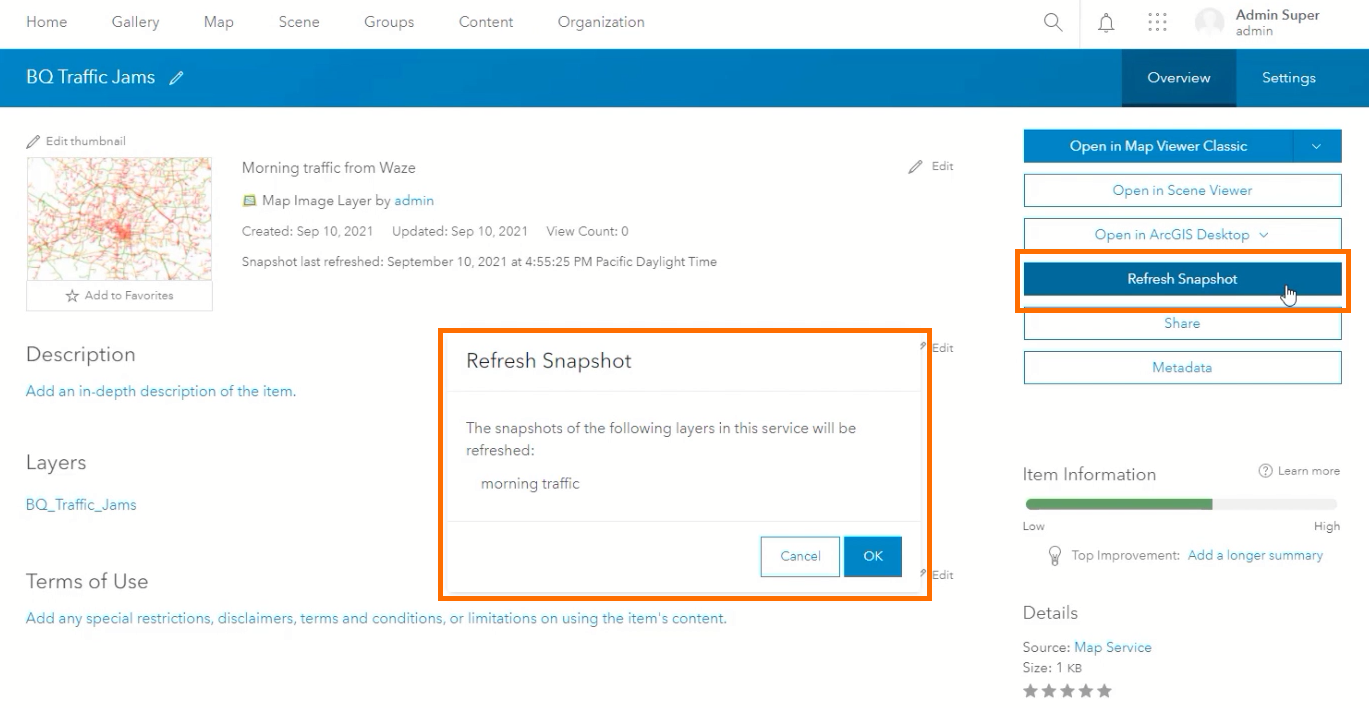

Any updates made to the cloud data warehouse data will not be reflected automatically in the map image layer.  For updates to be reflected in the image layer, the data must be manually updated.  This can be done on demand through the Enterprise portal.
Map image layers published as a snapshot can be refreshed in the Enterprise portal.
Materialized view
Sharing cloud data warehouse data through a materialized view means the data will be accessed directly in the cloud data warehouse but, unlike accessing the data directly, it will only be updated periodically.  The exact interval for this will depend on how the query layer was configured in ArcGIS Pro.
Similar to a snapshot, using a materialized view is more cost-effective than accessing the data directly.  Instead of every request made to the service having an associated request to the cloud data warehouse, every request made to the service will have an associated request to a cached query in the cloud data warehouse.
