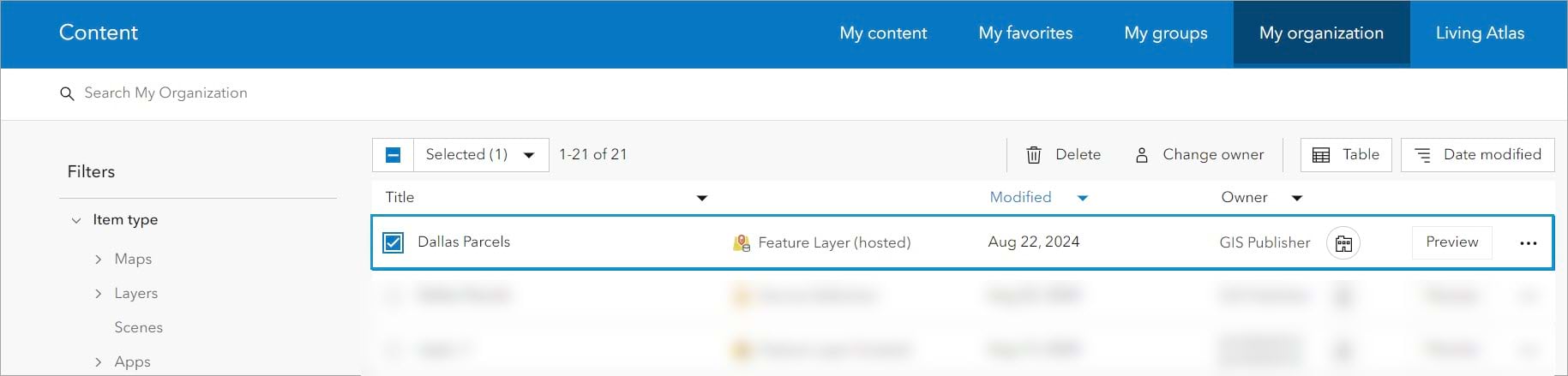

This workflow example demonstrates enabling response caching on a hosted feature service layer. The hosted feature services were already published to ArcGIS Enterprise.

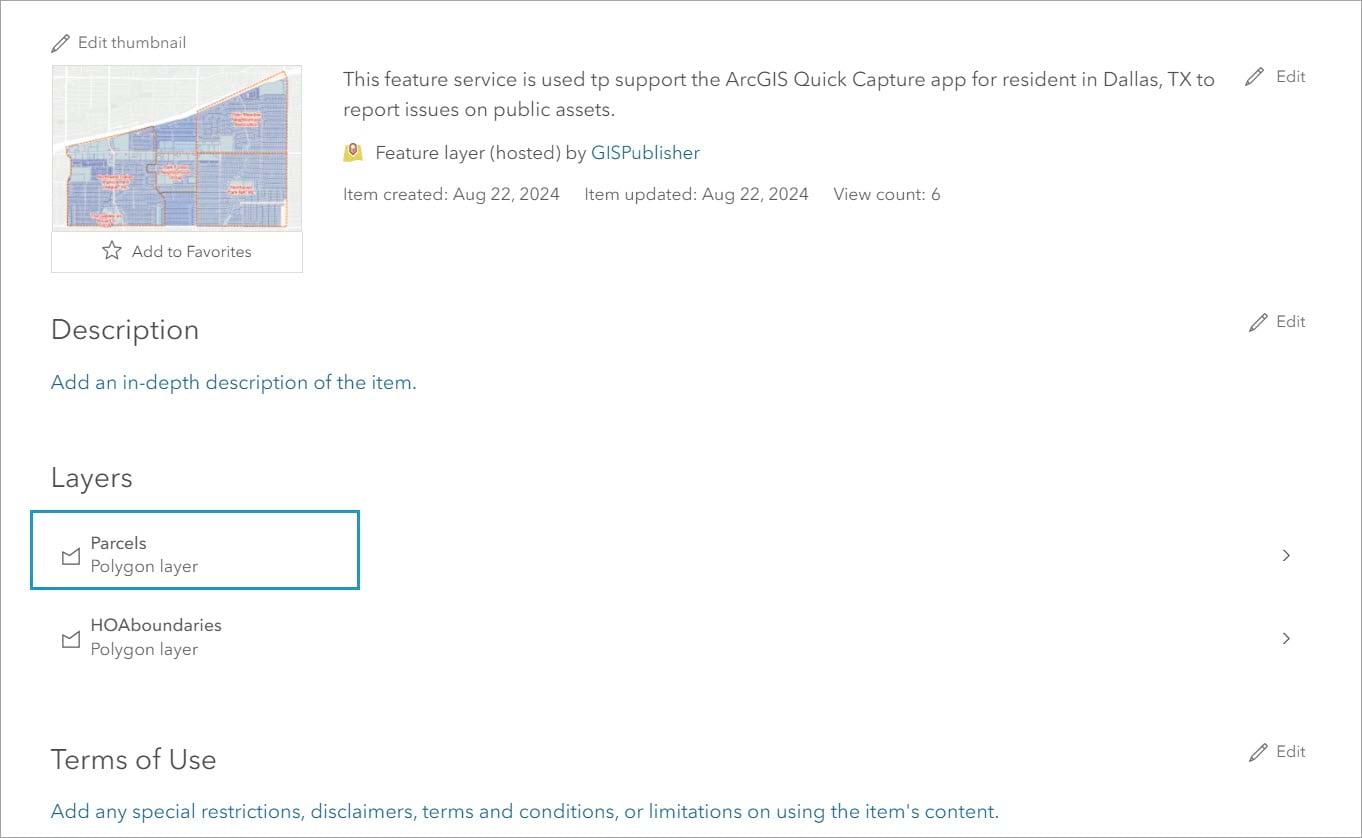

The hosted feature service contains two layers: parcels and HOA boundaries in Dallas, Texas.
The Parcels feature layer is often queried by multiple departments within the organization to retrieve parcel and owner information. To improve the web app performance, response caching will be enabled on this layer.

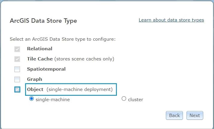

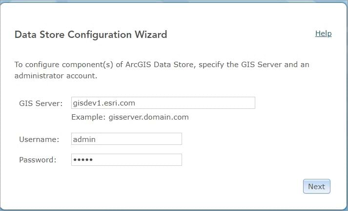

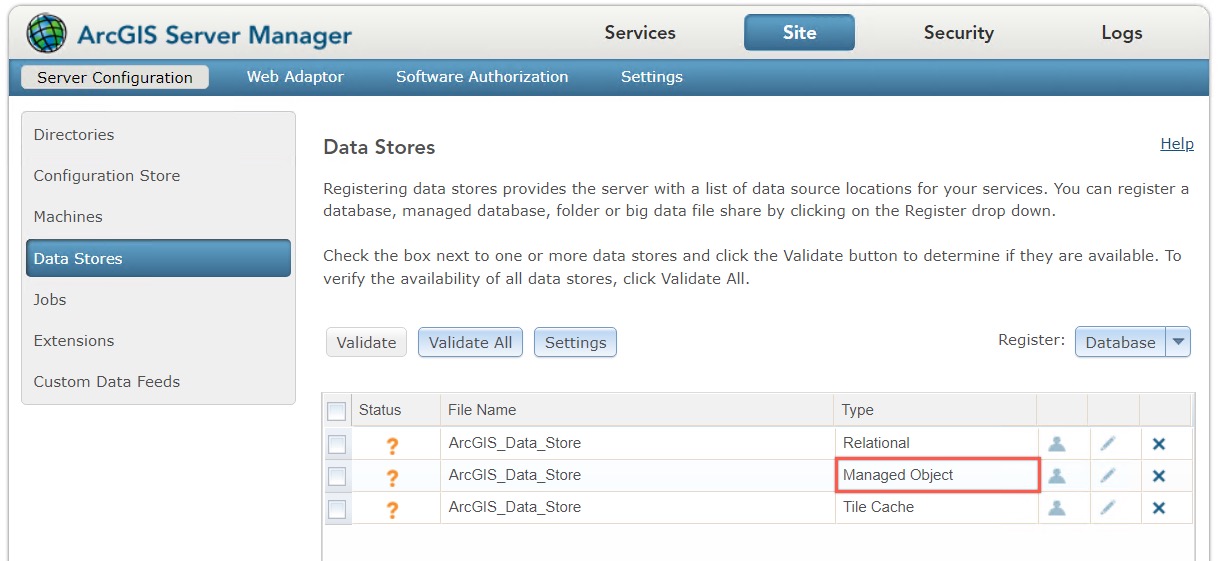

To use response caching, your deployment must be running ArcGIS Enterprise 11.1 or later. Additionally, the hosting server must have the object store registered. This storage type plays a key role in supporting hosted scene layers, hosted 3D tiles layers, cached query responses, and other more.
To verify whether your hosting server has the object store configured:
- Sign in to ArcGIS Server Manager for the hosting server as an administrator.
- Navigate to Site > Data Stores.
- Look for an entry labeled Managed Object under the Type column.
If you see this entry, your deployment has the object store. If not, check out the ArcGIS Enterprise: Migrate to the object store blog article to learn more.
Once you’ve confirmed your system meets the requirements, you’re ready to enable response caching on the Parcels web feature layer.

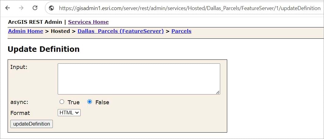

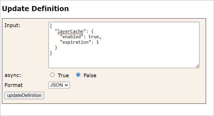

The updateDefinition operation allows you to update a definition property in a feature service layer. In this example, you will enable response caching on individual hosted feature services layer. This granular level allows you to control which layers will write response cache content to the object store.
1.To use the updateDefinition operation, access the layer admin resource using the following URL format:
https://gisdev1.esri.com/server/rest/admin/services/Hosted/Dallas_Parcels/FeatureServer/1/updateDefinition
2. In the Input box, set the layer cache to true and add an expiration date to define the number of days a cache will be stored before it is removed.
In this example, the response cache is set to expire after one day.
Once a cache is removed, a new response cache is created the next time the service is queried. The updateDefinition operation can be used to change or remove the expiration. An expiration value of 0 means the cache will never expire. The value for the expiration property must be an integer.
3. Click updateDefinition.
A JSON response confirms the operation was successful.

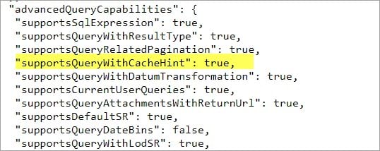

Once the operation is successful, you can confirm the change on the layer’s JSON page by checking for the “supportsQueryWithCacheHint” layer property.
Refresh the Parcels JSON layer page, and using the search shortcut, type supportsQueryWithCachHint.
Under advancedQueryCapabilities, you will see the supportsQueryWithCachHint property set to true. This indicates that layer queries support the cacheHint parameter and it has been enabled for response caching.

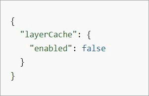

You can also disable response caching on an individual hosted feature service layer, using the same updateDefinition operation. But this time, set the enabled property to false.
This disables the response caching and sets the supportsQuerywithCachHint property back to false.
