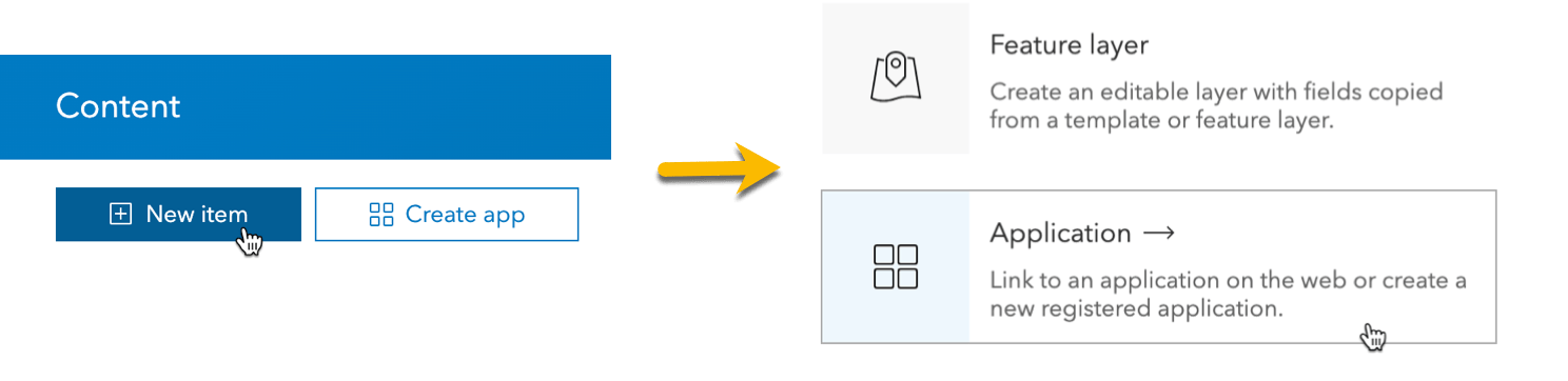

To register the widget, first log in as the administrator of ArcGIS Enterprise. Under My Content, click New Item and choose Application.
Create a new item

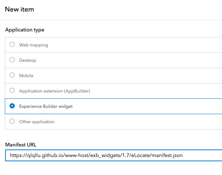

Then, choose Experience Builder widget, and fill in the URL from above step under Manifest URL. Click Next.
Choose Experience Builder widget item type

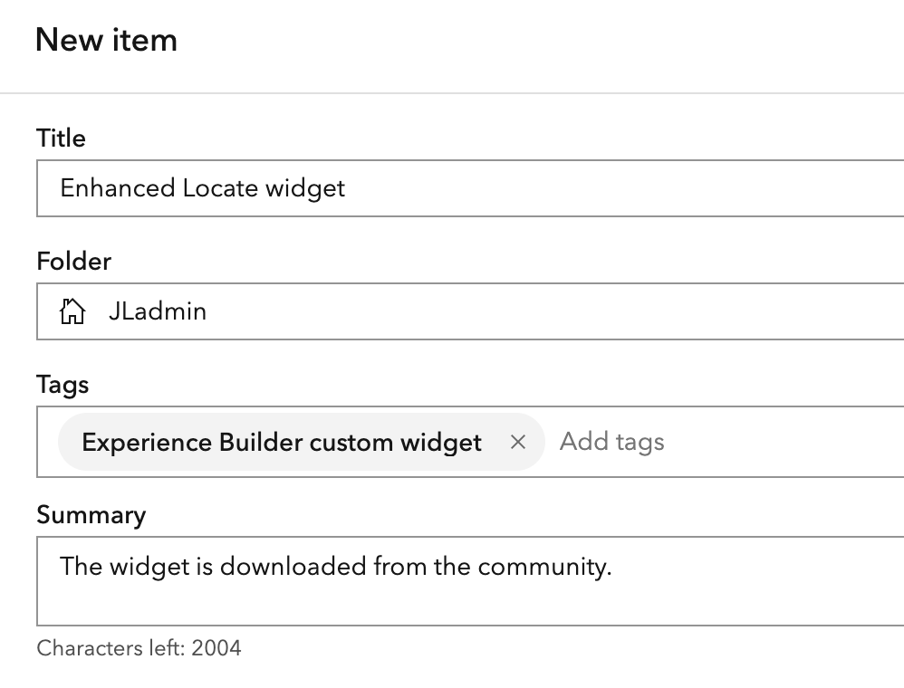

After providing a title, tags, and summary of the widget, save the item.
Item title

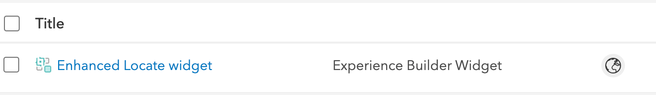

This new Experience Builder Widget item is an item just like all other items in ArcGIS Enterprise – it is listed under My Content and can be shared publicly or within the organization or a group. The job is done. Let’s log out.
The widget item listed in My Content

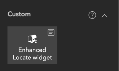

To use the widget, log in to the portal as a user with a privilege to create content such as the Creator user type. Create a new app with a map-centric template like Launchpad. When scrolling down the widget pane, we see the Enhanced Locate widget under the Custom section. We can add it to the app like any other out-of-the-box widget.
Custom widget in the widget pane

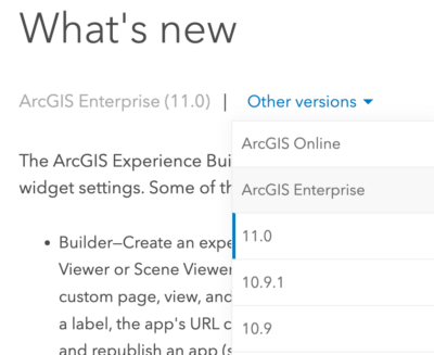

To find new Experience Builder features in your version of ArcGIS Enterprise, see What’s New.
What's new in ArcGIS Enterprise
