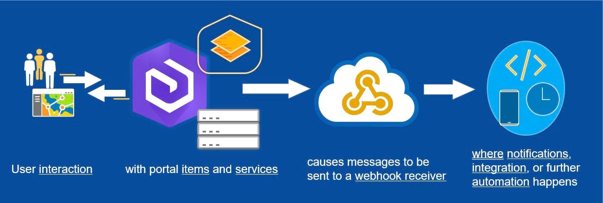

If you make use of feature services, ArcGIS Enterprise or ArcGIS Survey123, and you’re into automation, you may have heard of webhooks. What exactly is a webhook? This term describes a particular pattern of web communication between two applications: a source application and a destination application. The source application is where something happens, generating an event. This event causes a message to be sent to the destination application. The destination application must receive and do something with that incoming message. This something could be a notification, an email, etc. – the possibilities are endless. Generally, the term webhook applies to the entire end-to-end process connecting these two services.
For a webhook example in ArcGIS, consider an ArcGIS Experience Builder web application that permits hosted feature service editing. As individuals make edits in the app, the feature service is updated and a webhook configured on the underlying hosted feature service itself sends a message about those edits to a webhook receiver. The receiver has been configured to send an email notification every hour reflecting all the new edits. Contrast that scenario to one in which you would either need to manually check for new edits or run a script and identify new features added to the service: webhooks offer a proactive, automated push-like notification service.
A diagram showing a user signing into Portal for ArcGIS, causing a webhook message to dispatch to a webhook receiver, in turn triggering an email.
User interaction with services and the portal can generate webhook messages. Those messages are sent to a webhook receiver which is configured to respond by furthering automation or creating notifications.
