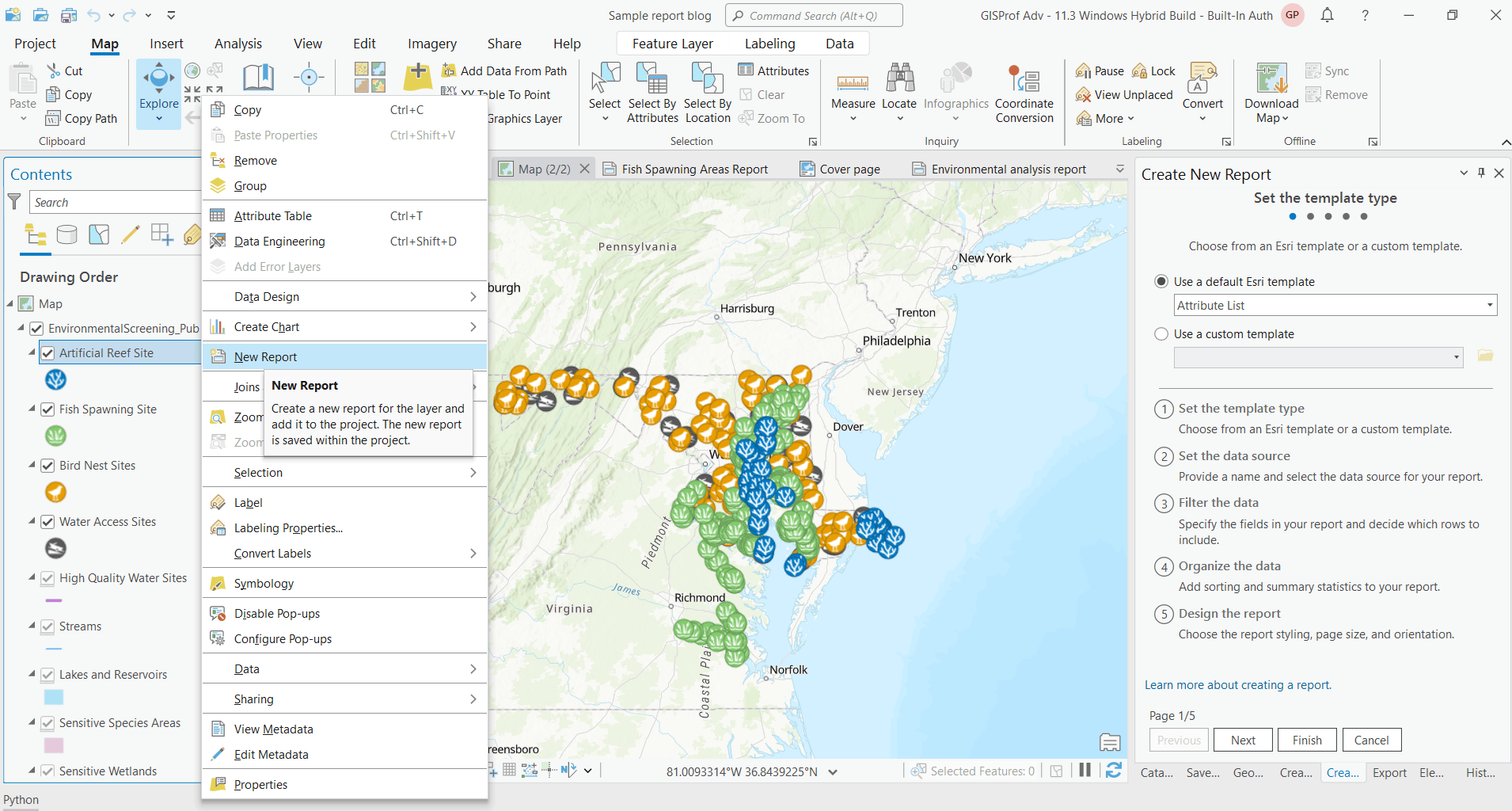

  1. Create a new Pro project with Map template
  2. Add data to your map (I added the same hosted feature service that I used in my Experience Builder App).
  3. From the content pane, create a new report by right clicking on a layer and then select New Report from the menu.
  4. Choose a report template. For this sample print service, I chose Attribute List. Click Next. There is another option Use a custom template. If you already have a custom template created, you can use that as well.
  5. Enter a Report name and select Data source (I chose Artificial Reef Site in this sample). Click Next.

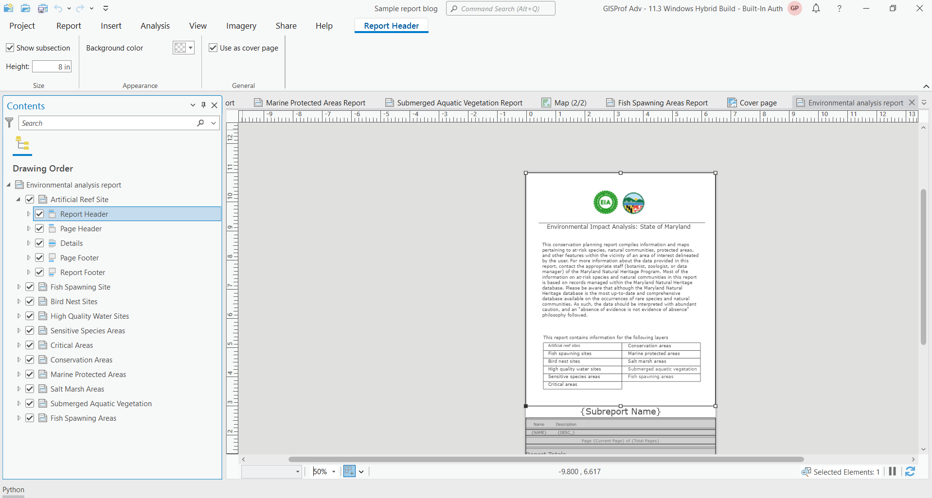

Design a cover page for master report
In this step you are going to design a cover page for the master report. You can add your company logo, images and text contents to provide context for your users.
  1. Select the first report from the view window (Artificial Reef Site Report in this sample) you created.
  2. Click on the Report Header from the Contents pane to select it.
  3. Next click on the Report Header tab from the top ribbon and increase the height of this section.
  4. Next click on the Insert tab from the ribbon and insert images (in jpg format), text and style them to create a cover page.
Cover page
