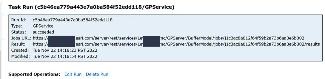

Task runs
The runs resources will list all the runs of a scheduled task, and for a geoprocessing service task run, it will list the Jobs URL and Result in the task run. From the Jobs URL, which corresponds to the Jobs resources of a geoprocessing service, you can get more information about the job, like the messages and final status. From the Result URL, which corresponds to the Results resource of a geoprocessing service, you can obtain all the values of all result parameters.
Task run of a geoprocessing service
task run
