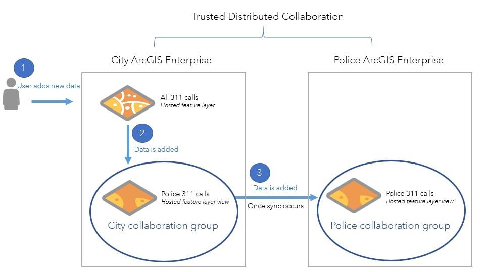

1) Edit features in the hosted feature layer
If the parent hosted feature layer data is edited, the update will also be available in the hosted feature layer view (for example, if the City updates the All 311 Calls layer, the City’s Police 311 Calls layer will reflect those changes). At the next scheduled sync, the recipient hosted feature layer view will reflect those edits (in this example, the Police’s 311 Calls layer).

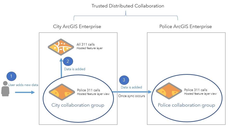

		2) Edit features in the hosted feature layer view
Looking at the reverse, if the source hosted feature layer view data is edited (City’s Police 311 Calls layer), the update will also be available in the source hosted feature layer (City’s All 311 Calls). At the next scheduled sync, the recipient hosted feature layer view will be updated to reflect those edits.

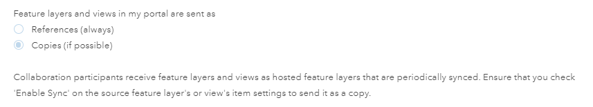

		How to share hosted feature layer views as copies
When sharing items to a group joined to a collaboration workspace, these items are sent to other collaboration participants. Ensure that the host of the collaboration (the organization that set up the collaboration) has set up participants with the appropriate send/receive access.
To share views as copies, collaboration administrators will need to configure the collaboration to send hosted feature layers and views as copies. Remember that you then need to enable sync on the parent feature layer and the view to share it as a copy. If sync isn’t enabled, the layers will be shared as references.
