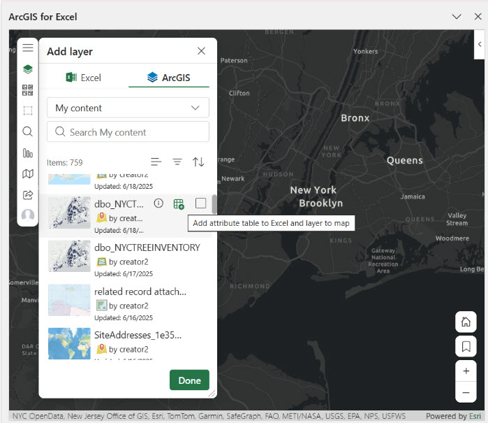

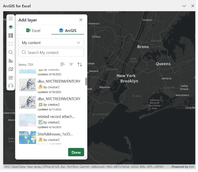

Sign-In to ArcGIS for Excel, open Layers and select ‘Add from ArcGIS’.
After selecting  to add the attribute data to Excel and layer to map , the attribute data from your ArcGIS layer will be added to a new Excel worksheet, and the ArcGIS layer will be added to the ArcGIS for Excel map.
