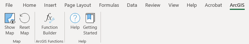

Step 1: Open your spreadsheet in Microsoft Excel and click the ArcGIS tab.
ArcGIS tab with ArcGIS for Excel tools

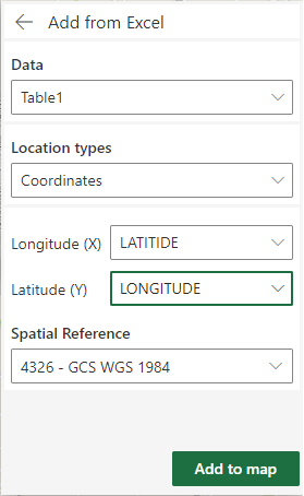

Step 5: Choose an appropriate location type and match the fields in your worksheet to the fields in the Add from Excel pane. For example, if your data contains latitude and longitude values, select Coordinates and match Longitude and Latitude to the appropriate columns in your spreadsheet.
Add from Excel pane

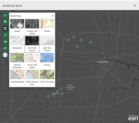

Step 7: Change the basemap to Dark Gray Canvas so your property symbols stand out.
Locations as symbols on the map and Basemap gallery

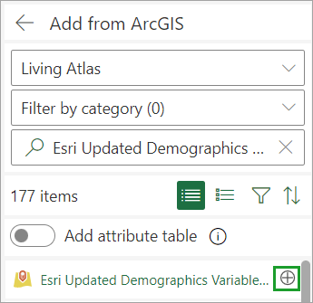

The gallery updates to show data in ArcGIS Living Atlas. You can sort results by date, title, view count, or owner, or you can filter results to only show items in specific categories or regions, or by type, tags, or status. In this case, you’ll search for the item using the Search field.
Step 10: In the Search field, type Esri Updated Demographics Variables and click the Add button next to the Esri Updated Demographics Variables layer.
Esri Updated Demographics Variables layer added

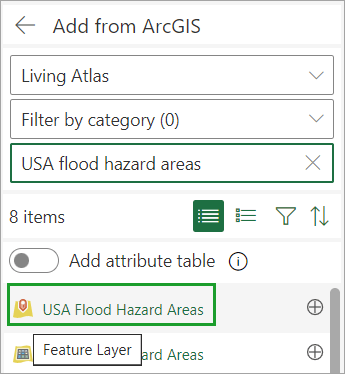

You also want to see flood risk data from ArcGIS Living Atlas. Again, you’ll find it through a targeted search.
Step 11: In the Living Atlas search box, type USA flood hazard areas and add the USA Flood Hazard Areas feature layer to the map.
USA flood hazard areas feature layer selected

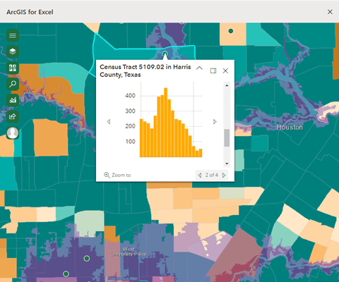

Step 12: On the map, zoom in to view the area surrounding a potential investment property.
Now you can explore the data in the map to decide which property is the best investment. You see one in an area with high home values and low flood risk. That looks like a good choice.
Map with pop-up showing median home value
