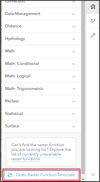

In addition to the raster functions available in Map Viewer, you can also access raster function templates from within your organization or ones that have been shared online. The raster function templates can be accessed with the Open Raster Function Template button, found at the bottom of the raster function list. Click the button and you will be presented with an interface that will allow you to access the raster function templates. When the desired raster function template is found, then select it, and click Confirm. The raster function template will appear in the raster analysis pane and can be run just like a raster tool.
Accessing raster function templates with the Open Raster Function button.
The Open Raster Function template button allows you to access raster function templates shared online.

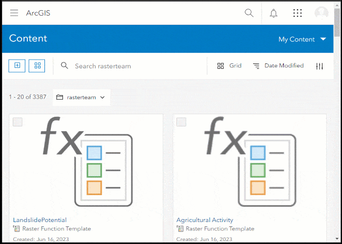

If you need to create your own raster function template, you can add a new raster function template using the Content page’s New Item interface.
Adding a raster function template with the Add Item interface
Raster function templates can be added to your organization from the Add Item interface.
Once the item is added to your ArcGIS Online organization, the raster function template can be opened in the raster function editor, where you can combine any of the available raster functions together to create your raster function template.

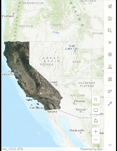

Following creation, you can apply processing templates to imagery layers while in the map. It’s already possible to add processing templates to dynamic imagery layers, but now you can apply the processing templates to tiled imagery layers too. This is a beta feature for tiled imagery layers that currently supports a selection of raster functions, however support for more functions will be included in subsequent releases.
In the meantime, you can use the same process you use for importing processing templates to dynamic imagery layers to visualize your tiled imagery layers. Simply click on the Processing Template button and import a processing template to create a custom visualization. This processing template could be a particular band combination, raster band math, or a combination of raster functions to generate a thematic imagery layer that you created. Additionally, there are raster function templates available from ArcGIS Living Atlas and those that have been shared on ArcGIS Online that can be applied to your imagery layer.

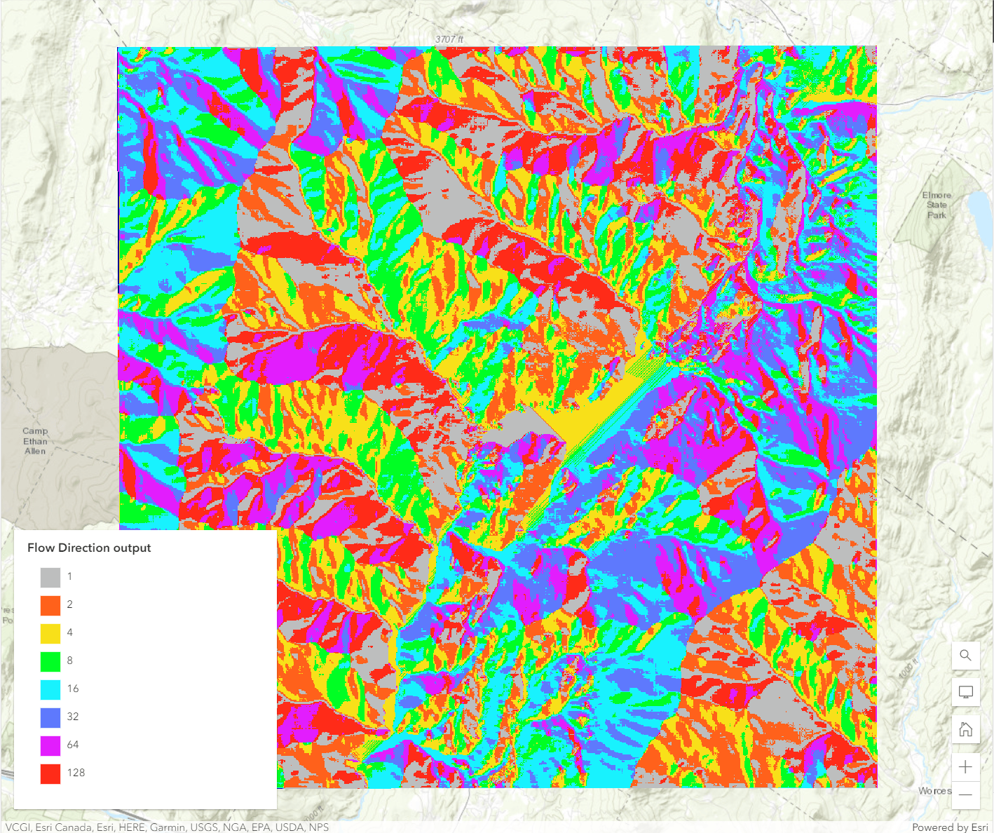

Flow direction output raster layer
The Flow Direction tool creates a new raster layer indicating the direction

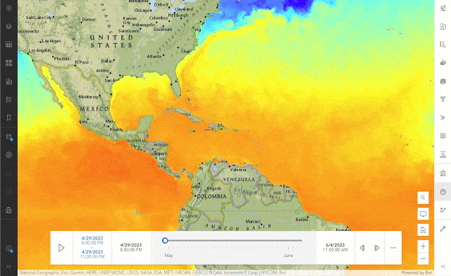

You can now display multidimensional data with the dimension slider in Map Viewer. The dimension slider looks like the time slider, but with one key difference. Unlike the time slider, which only operates on time, the dimension slider is based on the range of values within your multidimensional data and is not limited to time.
Any dimension that is available within the multidimensional imagery layer can be visualized in the dimension slider. So if your multidimensional layer has other dimensions like depth, they will also be available. All of the dimension sliders are visible by default when you add the multidimensional data to the web map. They can be turned off by disabling them in the Multidimensional settings for each dimension.
The dimension slider can be used to animate the multidimensional layer in the map, or to manually select a particular slice of the multidimensional data. Simply click on the slider to see the current slice and then click and drag to change manually.
Multidimensional slider in Map Viewer
Multidimensional dimension slider in Map Viewer.
