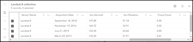

There is a layer configuration called Image collection, in which you can maintain the metadata about the input images. An attribute table will be included with the image collection that allows you to maintain the metadata, which can be used to provide additional display and filtering options. If a mosaic dataset was used to create the dynamic imagery layer, any field that you add to the attribute table in ArcGIS Pro will appear in the attribute table. The tables can be accessed in the map to view the attributes or use them to modify the display of the dynamic imagery layer.
Dynamic image collection attribute table in map viewer.
Dynamic imagery layers with the image collection layer configuration have attribute tables that can be visualized and used in the map.

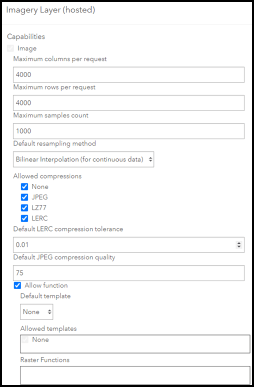

There are many options to control the display of the imagery layer. You can change the properties when the dynamic imagery layer is created. The first set of properties you can modify control aspects of the imagery layer and affect the way it is displayed. These properties control different aspects of the display and use of the imagery layer including the following:
  • Default resampling method
  • Compression
  • Default processing template
  • Allowed fields (image collection)
  • Allowed mosaic methods
  • Allowed mensuration capabilities
These properties are in the Item Details page for the imagery layer where you can modify aspects of the dynamic imagery layer. Here is one of the ways the creator of the dynamic imagery layer can ensure that it is used as desired by end users by changing the default look of the imagery layer.
Dynamic imagery layer properties in Item Details page.
In the Item Details page of the dynamic imagery layer, you can modify additional properties to control the display.
If the input imagery data is a mosaic dataset, you can even alter the default properties of the mosaic dataset to control the order of the input images, what metadata is included, or other mosaic dataset properties. Mosaic datasets can be used as input imagery in ArcGIS Pro with the Create Hosted Imagery wizard. This process also allows you to add more fields to the mosaic dataset that will appear in the dynamic imagery layer with the image collection configuration.

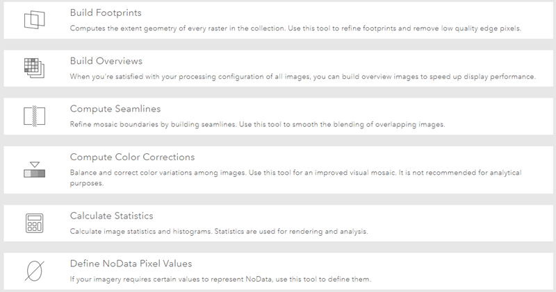

Dynamic imagery layers also allow you to perform image management tasks on the imagery layer. These tasks can be used to clean up the imagery layer by doing the following:
  • Modifying visible areas
  • Removing NoData areas
  • Adding overviews to improve performance
  • Correcting the color within the imagery layer
  • Calculating statistics to improve the display
Image management options for dynamic imagery layers.
You can use image management tools on dynamic imagery layers.

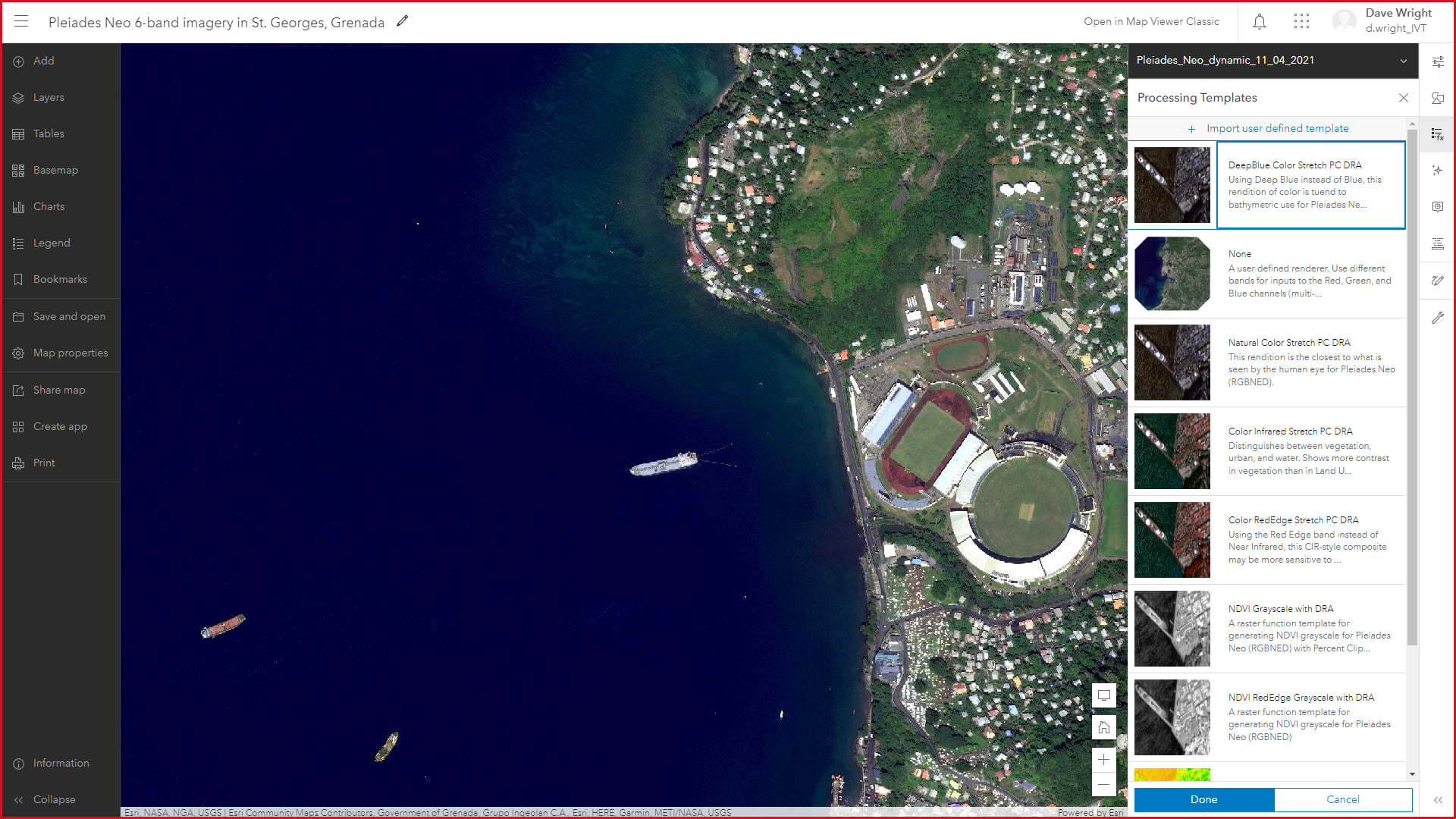

When the dynamic imagery layer is added to the Map Viewer in ArcGIS Online, there are additional properties that can be modified there. The properties here can control the band combination, which processing template is chosen, or even which input image shows up on top. All of these options are possible from within the Map Viewer properties.  When the dynamic imagery layer is selected, a few buttons will appear on the right side of the Map Viewer. The visualization options are controlled through four primary tabs:
  • Styles – With this property you can control the band combination, stretch type, and style. These same capabilities are also enabled for tiled imagery layers. Processing templates based on raster function templates can be added as symbology options.
  • Processing Templates – This property allows for adding raster function templates (RFTs) to the dynamic imagery layer. For Map Viewer Classic, the Image Display property allows you to add the raster function templates there. These RFTs can be used to change the visualization and create derived imagery layers from different analytical tools.

Creating a dynamic imagery layer (image collection) with satellite sensor data and choosing the raster type for that imagery layer will allow the metadata for that input imagery to be added to the attribute table. Most satellite sensor data includes additional information about that input image. For Landsat 8 images,  cloud cover and sun azimuth are two additional fields added to the attribute table. Using the filter, you can dynamically remove images that have over a certain threshold of cloud cover or are at a particular sun azimuth.
