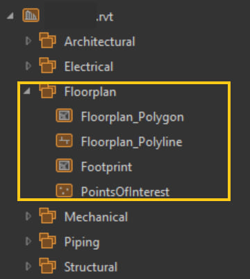

In ArcGIS Pro, the user will connect the folder storing the Revit files.
Once the folder is connected, verify that the Revit files store the ‘Floorplan’ dataset.
Add the Revit file sub-layers ‘Floorplan_Polygon’, ‘Floorplan_Polyline’, and ‘Footprint’ to the maps contents.
BIM file dataset used for conversion to ArcGIS Indoors
Check the connected folder for the 'Floorplan' BIM file dataset. Add the following sub-layers to the map contents.

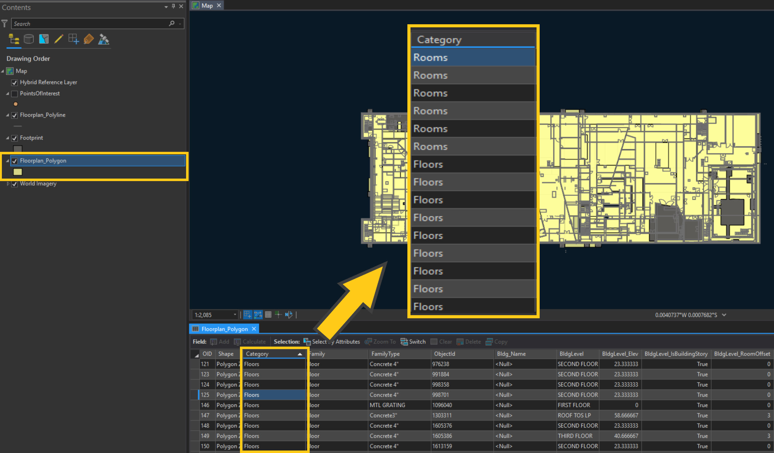

Once the Revit file data layers are added to the maps contents, open the attribute table for the ‘Floorplan_Polygon’ layer.
Analyze the ‘Category’ field to verify the Revit data contains ‘Floors’ and ‘Rooms’.
If the field only shows ‘Rooms’, the dataset lacks floors needed to convert into the ArcGIS Indoors ‘Levels’ layer. If the field only shows ‘Floors’, the dataset is unable to identify rooms to convert into the ArcGIS Indoors ‘Units’ layer. As mentioned above, make sure the field contains both ‘Floors’ and ‘Rooms’.

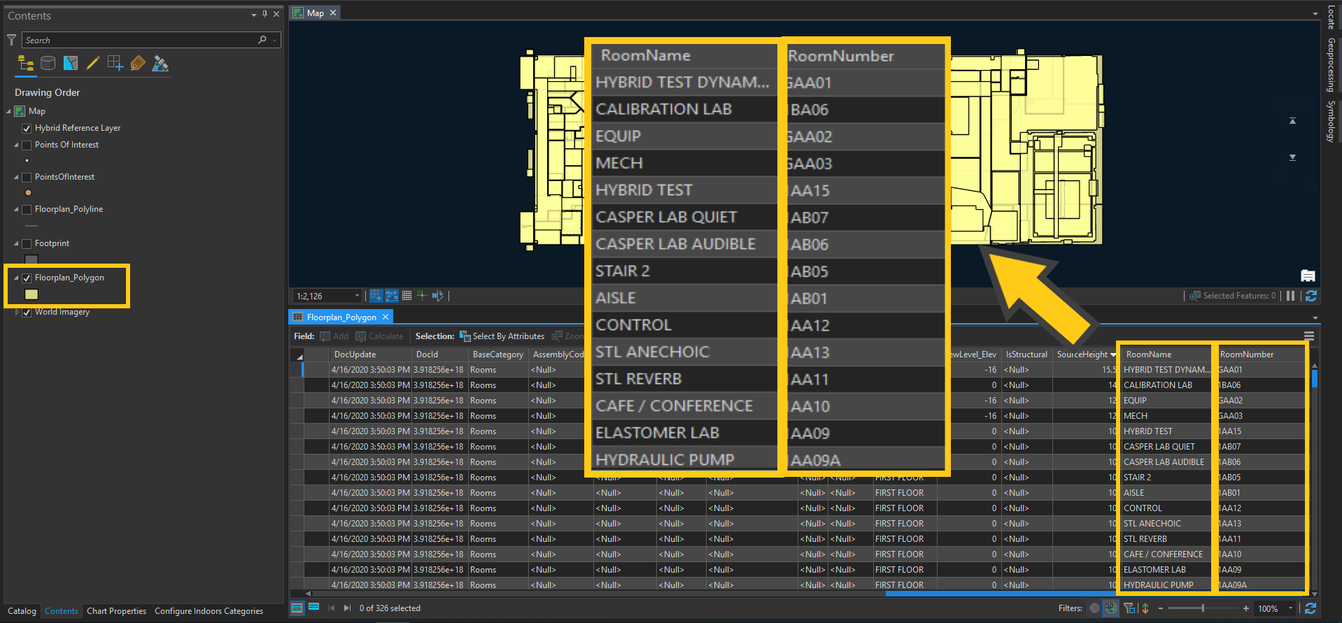

Additionally, in the same attribute table, verify that the ‘RoomName’ and ‘RoomNumber’ fields contain data.
These fields are important in the data conversion process, as they will fill in the ‘Use Type’ and ‘Unit ID’ fields in the ArcGIS Indoors layers.
Category Field Validation
Verify that the Category's Field for both 'Rooms' and 'Floors' are attributed.
Verify RoomNames and RoomNumbers field have data
Verify that the 'RoomNames' and 'RoomNumbers' Field contain attributed data.

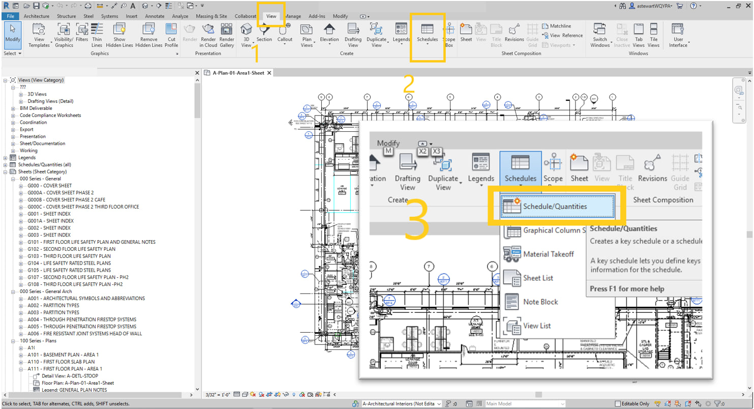

Step 1
Click on the ‘View’ tab in the ribbon.
Then click the ‘Schedules’ button.
Afterwards, select ‘Schedule/Quantities’.
Selecting 'Schedule/Quantities'
Follow the numbers to select ‘Schedule/Quantities’

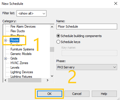

Step 2
For the ‘New Schedule’ window, scroll down in the ‘Category’ section and select ‘Floors’.
Then, click ‘OK’.
Selecting Floors
Select 'Floors' for category, and then click 'OK'

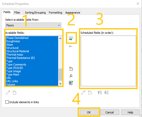

Step 3
Select all the following ‘Available Fields’
Using the green arrow, bring the selected ‘Available Fields’ over to the ‘Scheduled Fields’.
Then click ‘OK’.
Scheduled Fields
Select all 'Available Fields' and add them to 'Scheduled Fields'

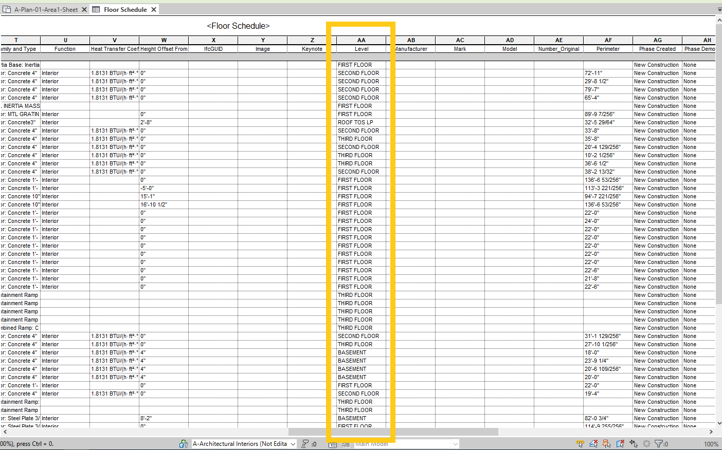

Step 4
Based on the previous step, a new tab was added to the top of the Revit workspace called ‘Floor Schedule’
Open the ‘Floor Schedule’ table and see if there is data.
If there is no data in the fields, the ‘Import BIM to Indoor Dataset’ tool will not properly run. If there is data, verify that the Revit floorplans contain ‘Levels’ associated to the Revit file for that building and that it is classified in the table. Look at the image below, as it exemplifies what the Revit dataset should look like.
Verify there are Levels associated to your Revit floorplans.
