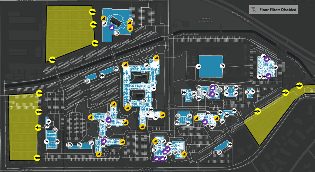

By adding Evacuation Zones in the data model, and connecting the routes from buildings to safety, I could use the spatial tools in ArcGIS Pro to run network analytics to find the best way to evacuate.
All Campus Routes
Evacuation Planning with all possible routes showing
Of the 2,000+ possible routes in my dataset (pictured in grey above), the tools figured out the one shortest route from each facility exit door to safety.

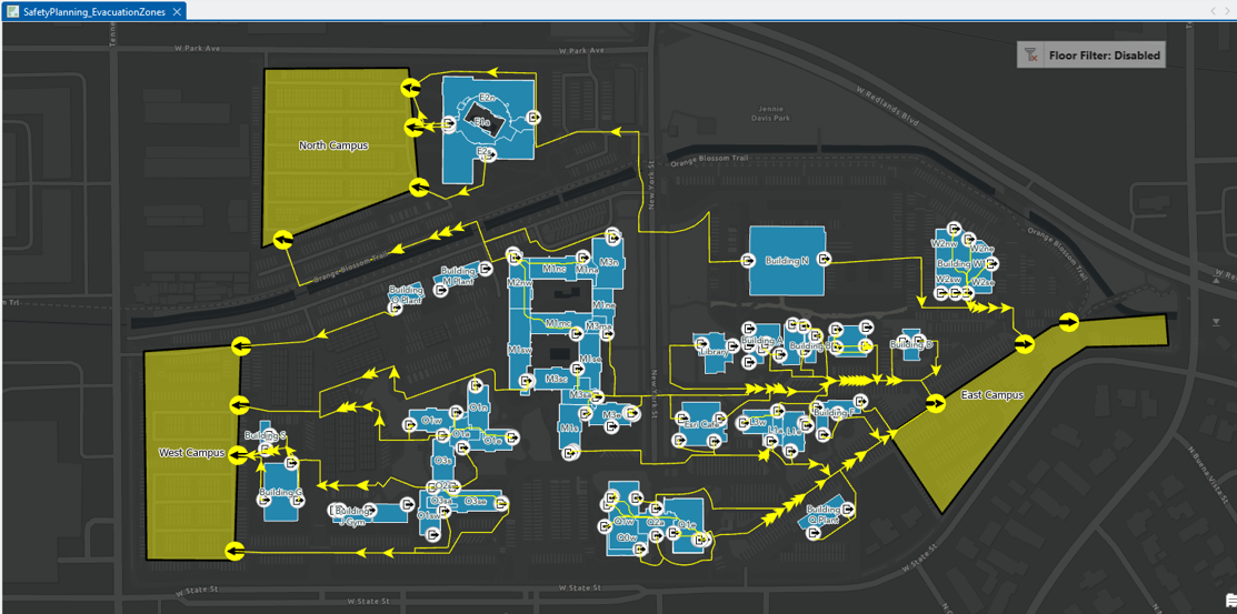

Within seconds, the single shortest route from door to safety was calculated and filtered in view (in yellow below).
Evacuation Planning
Evacuation planning to find shortest routes from exit to safety
