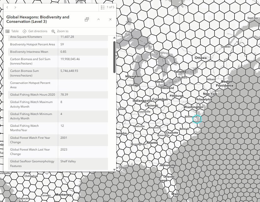

The newly released Global Hexagons for Biodiversity and Conservation layers provide a great foundation for illustrating how much pop-ups can enrich the experience of interacting with a map. These layers include over 50 attributes that summarize more than 20 different datasets, combining essential biodiversity and conservation data in one place.
screenshot of global hexagon field list

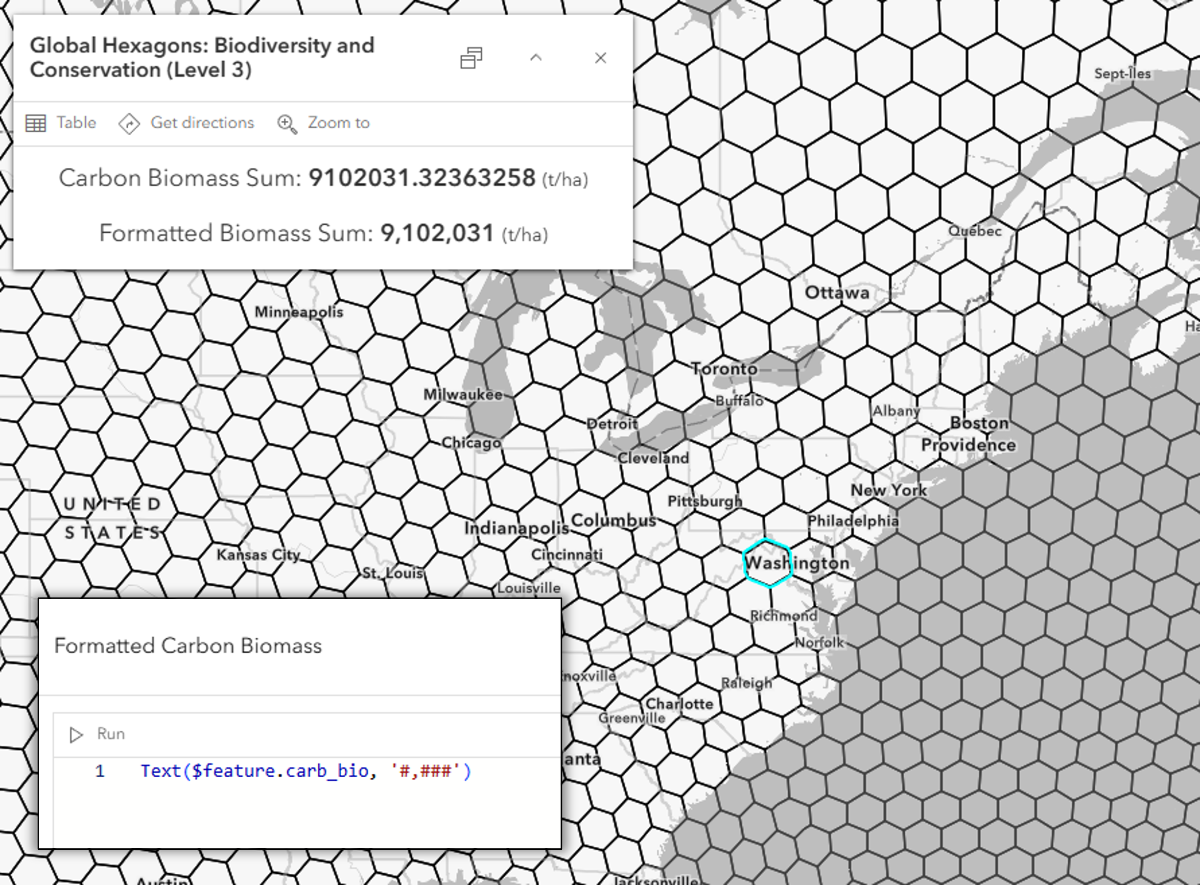

Formatting data is important when displaying information in a pop-up. In the example below, the function is applied to the field “carb_bio” or Carbon Biomass Sum (tonnes/hectare). The output is converted to a text value that allows you to group by thousands and specify significant figures.
screenshot of arcade function
Formatting values for a pop-up adds some clarity beyond the default table of values. Numbers are foundational, but we can do more!

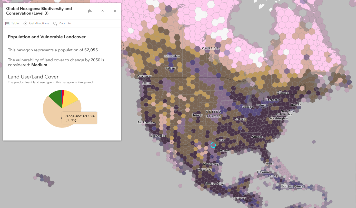

Let’s look at the relationship between population and projected land cover vulnerability in 2050. Symbology is a great way to translate numbers into a visual, but with an Arcade expression, we can add narrative context into what we’re seeing.
screenshot of global hexagons, relationship between population and vulnerable land cover
screenshot of arcade expression
The expression above uses a When() function to create conditional statements. If a selected hexagon meets the condition, it will return a descriptive statement instead of a number. This is a useful method to help translate numerical values into something more intuitive for the user. Combining the logic with some HTML, we can return a message in the pop-up that compliments the map’s symbology.

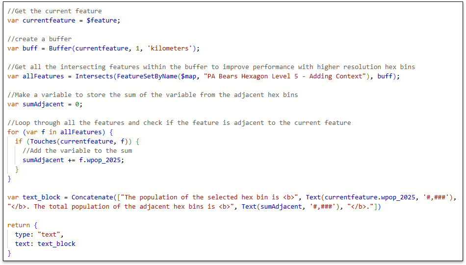

By using Arcade’s geometry functions, we can contextualize conditions for a selected hexagon to look at the relationship between population and maximum probability of black bear presence.
screenshot of layer popup

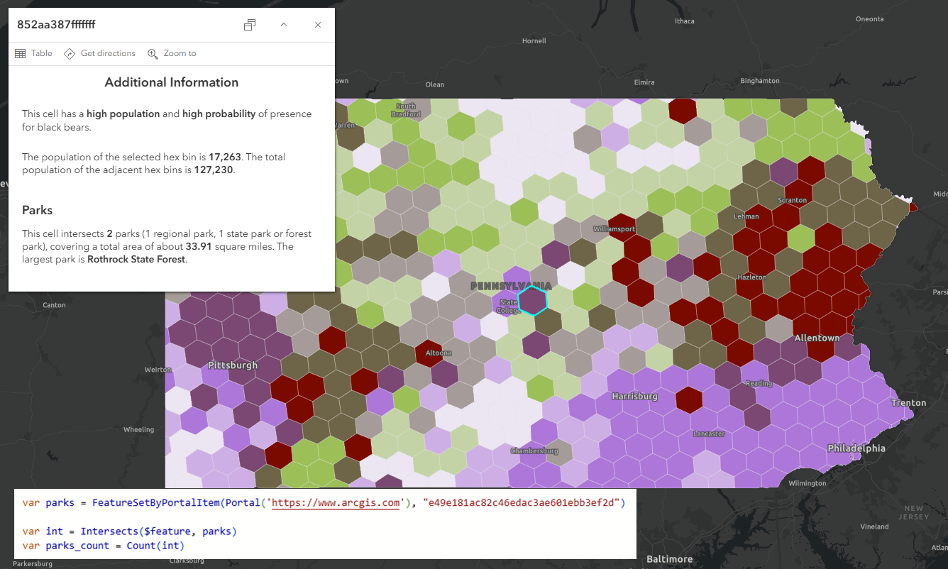

After you’ve pulled everything you can from your current data, you can use Arcade’s FeatureSetByPortalItem() to bring in supplemental data (without needing to add the layer to your map). This is where content in the ArcGIS Living Atlas of the World can provide great value.
For example, to explore black bear presence, we can bring in the USA Parks layer. I can access attributes to create a nice text snippet detailing the number of parks, park types, and the name/size of the largest park intersecting the selected feature.
screenshot of arcade example

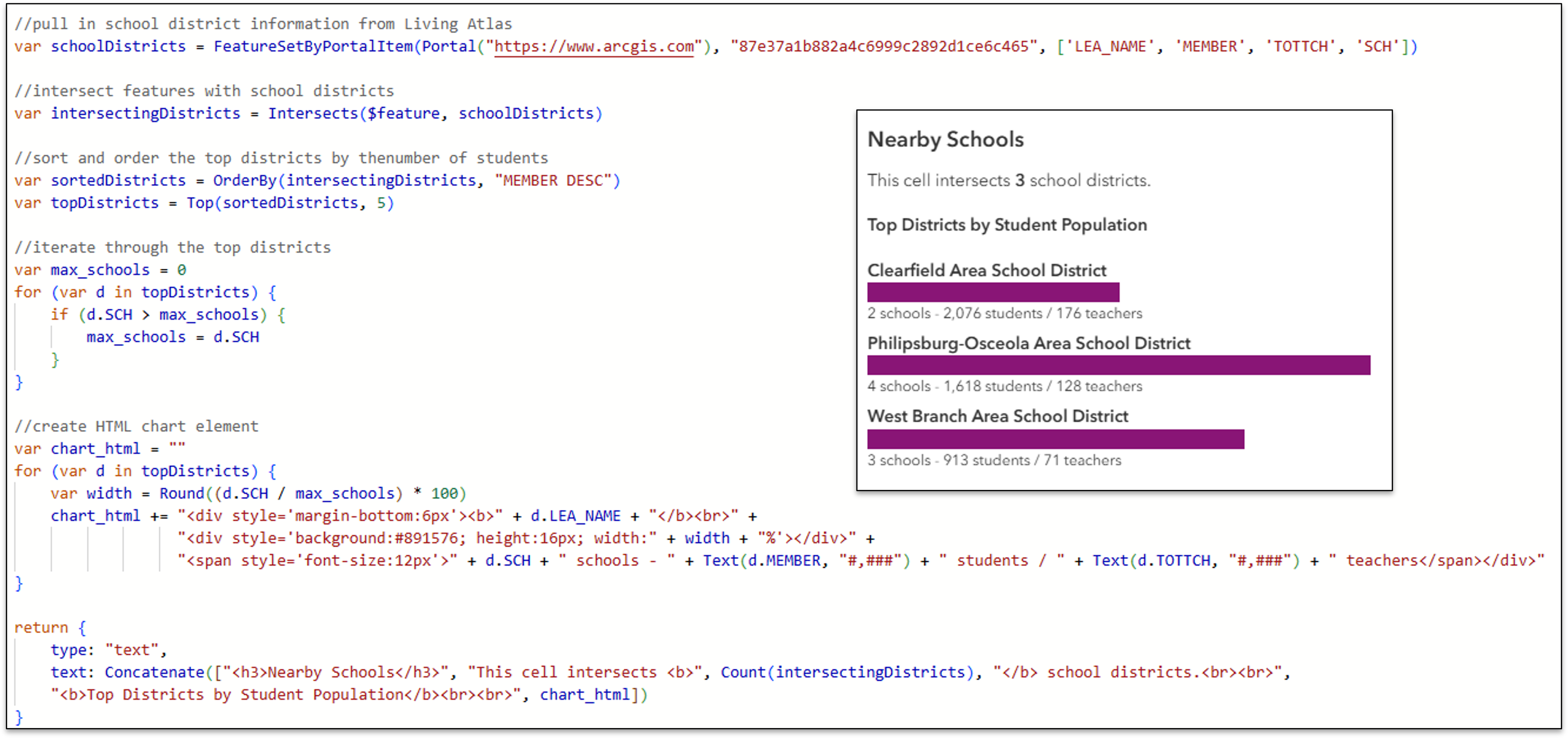

Another relevant dataset might be School District Characteristics, which includes attributes like number of schools, students, and teachers.
screenshot of arcade expression and school details

For example, instead of using the Media element to define a chart, you can also use HTML to build a more static bar chart.
Check out this map for the examples pulling in content from the Living Atlas.
screenshot of arcade expression with school details chart
