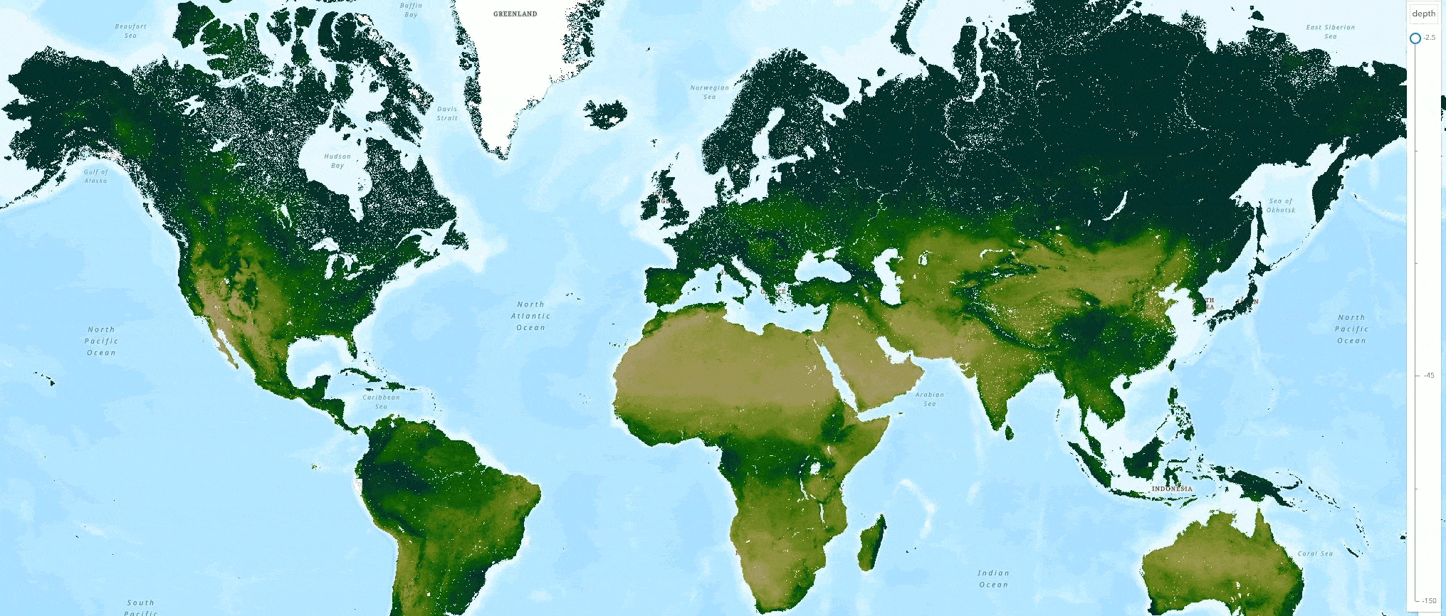

Animated GIF showing World Soils 250m Organic Carbon Density in six depths.
World Soils 250m Organic Carbon Density. Soil layers are served in six depth ranges in a multidimensional format.
Eleven soil themes, plus uncertainty, in six depth ranges. How do we serve all that in one bundle? The ArcGIS Living Atlas took cues from oceanographers and meteorologists and published maps in multidimensional layers, which have all different variables and depths together in one layer.
