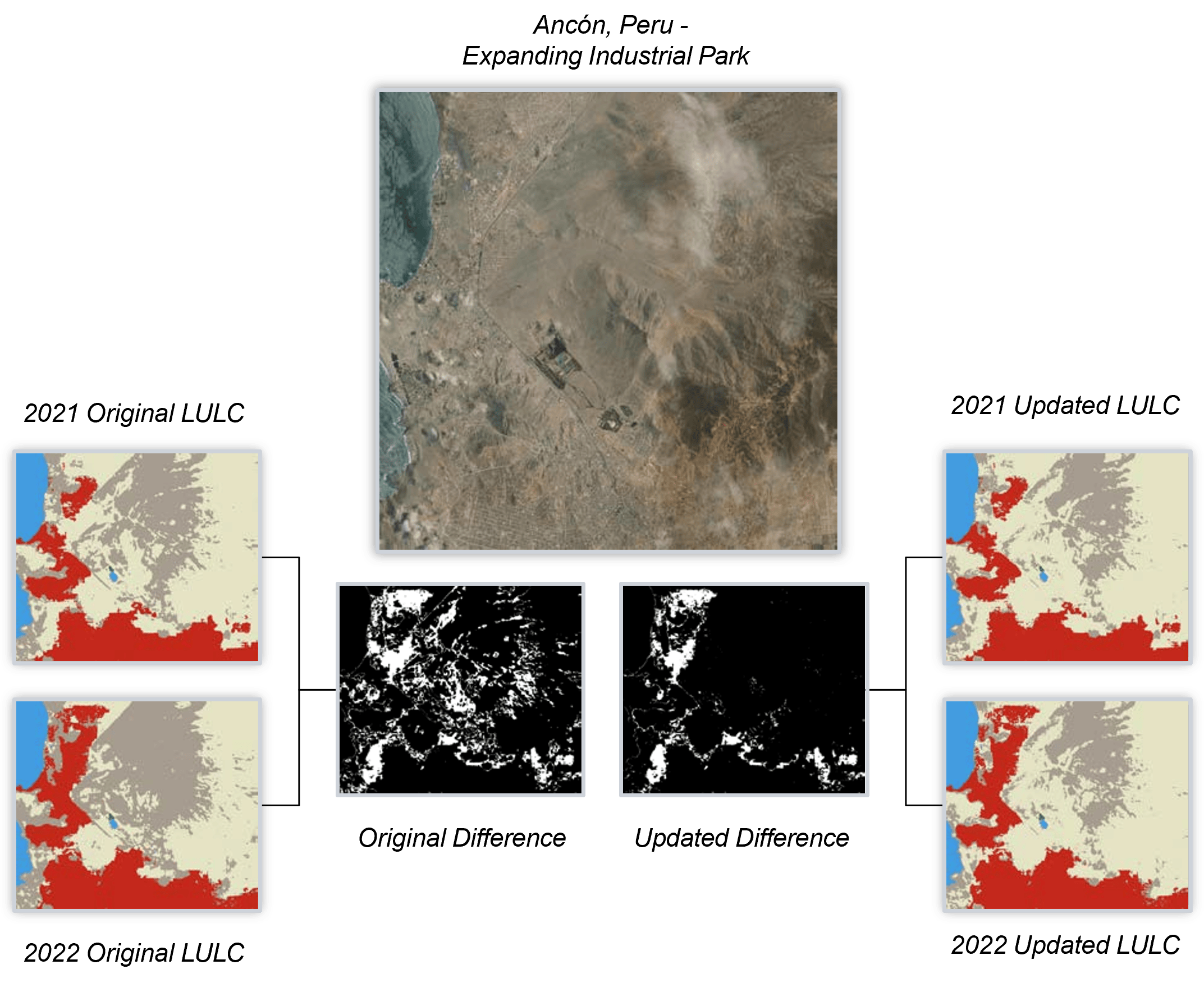

Change between two LULC maps can potentially signify an important and developing change in an area of interest. However, in some cases, classification results may vary from one annual cycle to the next due to modeling insufficiencies, variability in seasonal observations, and/or class ambiguity at 10-meter resolution. Such cases can lead to false or spurious change results when conducting temporal change analysis. As demonstrated in the example below, the recent improvements can significantly reduce spurious change.
Above is an example of the improved temporal consistency. With less spurious change, the 'built area' development is far more noticeable in the updated difference map.
With the improvements to the temporal consistency, users assessing temporal change across the time series can be confident that what they are seeing represents the natural world.
