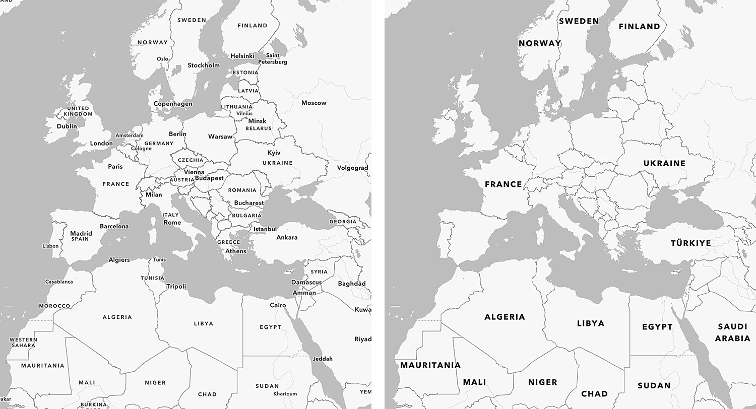

I decided to set a minimum label size of 16px for this exercise (most of our current basemaps use a minimum size around 9px). At very large scales I increased the size to around 20px and to as much as 30px. The most significant difference is at smaller scales. At larger scales many of the labels were larger already.
To accommodate the larger size, I introduced the labels at least one scale later than on the current map, and often two or more. This means that at any specific scale you will see fewer labels. Here are some before/after comparisons. The current map is on the left, and the ‘large label’ version on the right:
Side by side comparison of the current Human Geography Basemaps with the large scale version. This shows Europe at small scale
Zoom Level 3

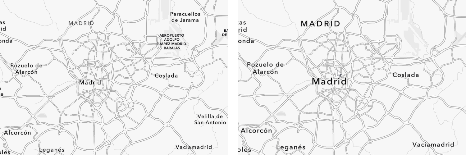

Side by side comparison of the current Human Geography Basemaps with the large scale version. This shows Madrid, Spain at regional scale
Zoom Level 10

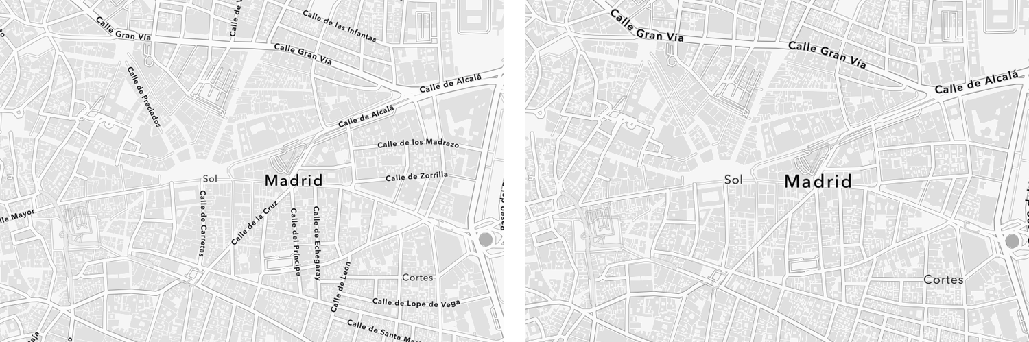

Side by side comparison of the current Human Geography Basemaps with the large scale version. This shows the center of Madrid, Spain
Zoom Level 15
If you find a label is missing, zoom in a few times and you should find it available again.
