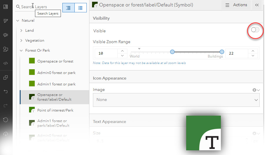

Make sure you are logged-in to your account. Open the VTSE, choose World Topographic Map (I’m making it easy – it’s the first option top left, and the default), then go straight to ‘Save As’. You are going to build two versions, so call this one ‘World Topographic Base’. Now settle in, because at the moment we don’t have a tool to help you with this:
Choose the layers option (second down in the left side panel), open the first layer, and start working through the sub layers. You are looking for any item that has a ‘T’ in the icon – this means it’s a text/label item. Switch it off
A label layer highlighted in the Vector Tile Style Editor
It’s as simple as that! … except that you have to work through all of the sub-layers to find the labels and repeat the process, and there are a lot!
There are some short-cuts though. Some group layers only contain labels (‘Landform’ is one in the Topographic map). If this is the case, you can switch the whole group off. Others, like ‘Populated Places’ have a majority of label layers. Here, it’s quicker to switch the group off, then find the non-label layers and switch them on again.
Make a thorough exploration of the map at all scales to find that inevitable label feature that you missed. Click on it, and it will open that item.

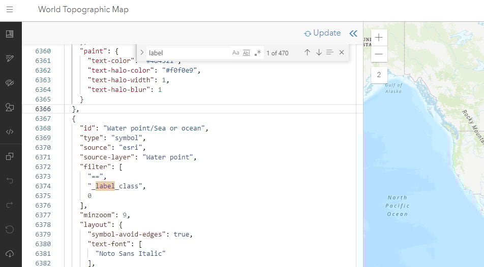

The Code Option
How comfortable are you at working with code? If you know your way around, this may be quicker.
Open the Edit JSON option in the side panel and search (Control/Command F) for ‘Label’.
The Vector Tile Style Editor with the code editor open
Usually, but not exclusively, our code is arranged with the label layers at the bottom (drawing last).
Watch out for combined symbol/label items – they may not include the word ‘label’. If there are any layers you want to leave behind (in our Topographic Map example, there are some symbol layers towards the bottom), cut and paste them up and out of the way.
Once you have figured out what you are working with, you can select the items to be removed, then delete the code. Remember this is a one-way option! – once you have saved it, the layers are gone. Also, be careful what you delete at the top and bottom of your selection. If the map won’t refresh, it probably means you’ve deleted something you shouldn’t (or left something behind), maybe just a comma or a bracket.
As before, you will go through this sequence twice: Remove the labels (plus custom content) for the base layer, and everything else for the reference layer.
In a different context, John Nelson created one of his video segments on this process: https://youtu.be/frmqi8mL0vQ
An alternative to deleting the code is to add the line: “visibility” : “none”  to each item you want to hide. This could take some time however, and, in essence, it is what happens when you switch it off in the Layers option.

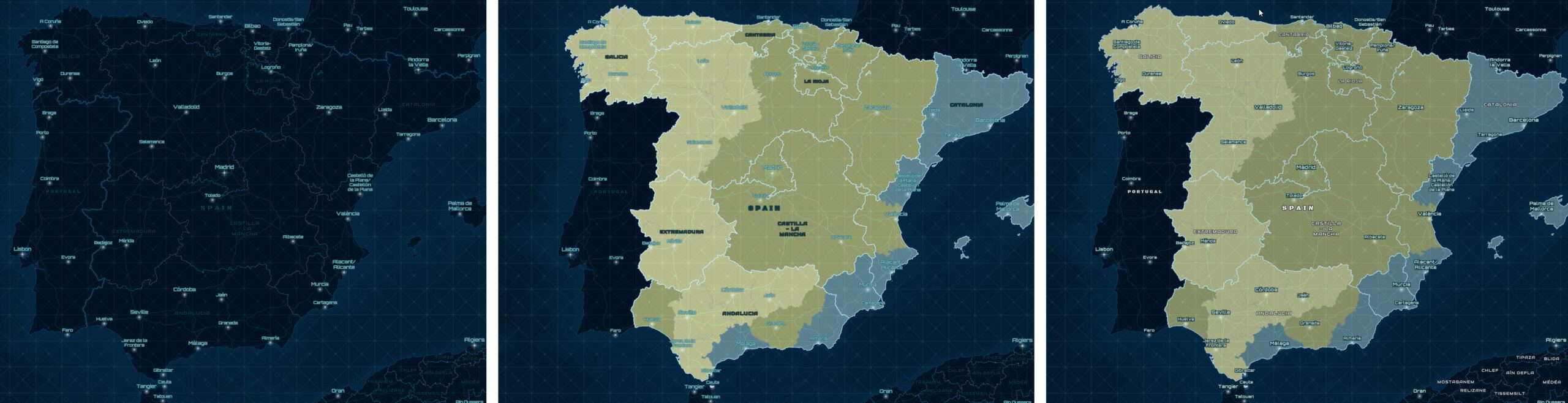

Add your two components to the basemap layer in a web map, making sure that the reference layer is moved to the Reference section. If you already have your functional map layers prepared, add them. If not, look for a similar layer in the Living Atlas and add that. Zoom/Pan around the map to see how the reference layer is working. The relationship of a reference layer to your content is different, and there is no guarantee that the choices made when the basemap was designed will work well here.
In this example, the Nova Basemap labels are difficult to see when content is placed below them (A map from the Living Atlas showing foreign population in Spain). An adjustment to labels and haloes in the VTSE resolves that.
3 maps of Spain, showing the NOva basemapp and adjustments to work with a subject map
Don’t forget to look at label haloes. We use them in most of our basemaps, and  they are designed to work with the information already there. This may mean that they have some color in them, and you might need to change that, along with width and blur settings, to get something more functional. If you plan to use your new basemap on more than one product, choose a neutral and unobtrusive color for the halo.
